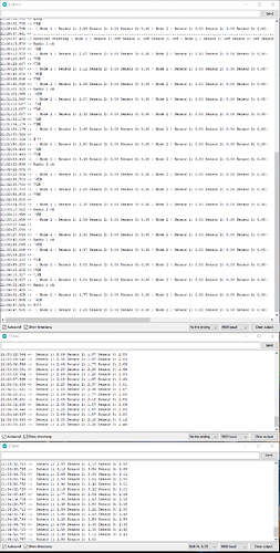

I'm trying to make a sensor network using 2 transmitter units and 1 receiver.
The transmitter units are consisting of:
1xArduino UNO
1xNRF24l01
3xCapacitive Soil moisture sensors
The receiver consists of:
1x ESP32 WROOM 32UE
1x NRF24l01
Transmitter code

As you can see from the code, the plan is to get the readings, transmit them using the NRF24l01 modules and then upload them to Thingspeak, now there are some issues.
Not all data is being received (See serial monitor output image, COM14 is Receiver, COM 6 is Node 1, COM4 is node 2)
When data is being received, some of it is garbled.
Afaik my connections are good since there is some data being sent, i'm worried that it is a problem with my code.
What would be a more efficient way to write my code?
My coding and electrical knowledge mostly ends with this project so pls be nice, and I would appreciate any resources to improve/learn more.
Thanks in advance
Please advise
