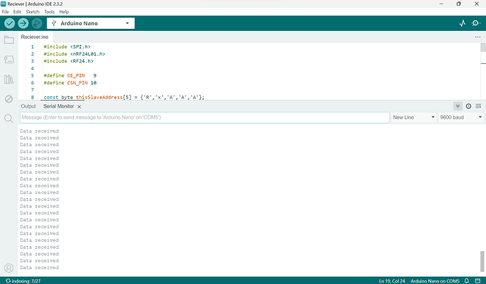

I'm using this tutorial to receive data from an nRF24L01+ from my PIC16F1829 (TX).https://forum.arduino.cc/t/simple-nrf24l01-2-4ghz-transceiver-demo/405123/2
I am using an Arduino Nano connected to the nRF24L01+ as the RX using this code:
#include <SPI.h>
#include <nRF24L01.h>
#include <RF24.h>
#define CE_PIN   9
#define CSN_PIN 10
const byte thisSlaveAddress[5] = {'R','x','A','A','A'};
RF24 radio(CE_PIN, CSN_PIN);
char dataReceived[10]; // this must match dataToSend in the TX
bool newData = false;
    Serial.println("SimpleRx Starting");
    radio.begin();
    radio.setDataRate( RF24_250KBPS );
    radio.openReadingPipe(1, thisSlaveAddress);
    radio.startListening();
    getData();
    showData();
void getData() {
    if ( radio.available() ) {
        radio.read( &dataReceived, sizeof(dataReceived) );
        newData = true;
void showData() {
    if (newData == true) {
        Serial.print("Data received ");
        Serial.println(dataReceived);
        newData = false;
Even when I take off the nRF24L01+ so there is no connections at all, so its just the USB connected to the nano, all I get in the serial monitor is "Data received" being spammed very fast. I have bought new nRF modules and swapped them out, tried uninstalling and reinstalling the IDE, and I can't understand why it is just saying "Data received". Anything would help, as I am fairly new to Arduinos. Thank you.
Many helpers don't spend time om watching tutorials and You miss helping power.
Please show that in schematics. Words are always uncertain, leads to misunderstandings. Insufficient power os a common reason for failure.
Screen shoots are never appreciated... Use text copy.
