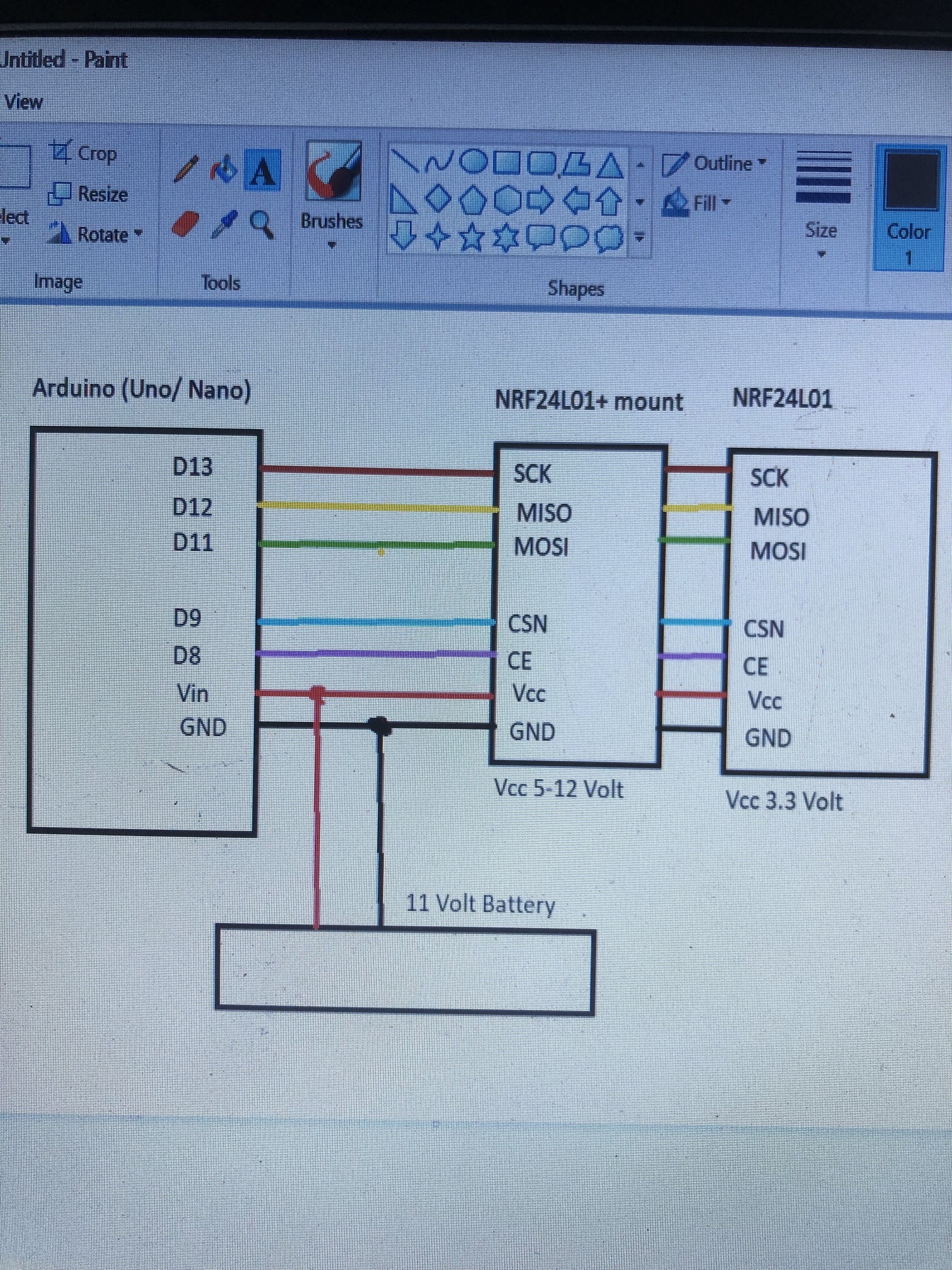

I tried few nRF24L01+ modules using several examples including basic one that came with the NRF library or that illustrated by several contributors. The modules only work the first time they are connected, after uploading a new program all modules fail at radio.begin() and all print details output zero info.
The power during different tries are either 2AA batteries or nRF24L01 mount (sold separately and more than one tried).
None of the modules seem to have apparent physical damage, hot etc or shorted between different pins (apologies this is my knowledge limit). During test all pins are connected firmly and correctly and simplest proof is that it does work fist time for any period of time.
I have added debug points to the NRF library and it appears write_register operations do not take effect.

You should show your wiring.
You should post your code.
a7

I can't look closer at your code right now, but I do remember that the radio can get itself jammed, somehow.
A power cycle reset clears it up. This may explain your works once observation.
It still may mean you are placing it in that state inadvertently through something in the code.
As for your questions, no and no.
Although it can get confused, you can't harm the moduke firmware and there is no reflashing or reprogramming that I know of.
And aside from seeing obvious damage, the only test available is to go back to a circuit you did not mess with and code you did not alter form examples taken from tutorials or other explainers. And see if a pair of radios works.
Did you build a pair of these and see them work just slavishly following every step of a legitimate tutorial? There are quite a few, all hammer at some essential points. among which find themselves
  • use adequate power and a filter capacitor of some good size
  • separate the two Arduino+NRF24L01 units by a few meters at least

Code whether original or modified works if already loaded on the Arduino. Once I upload a change whilst the module is connected or possibly restart the power to the module (and arduino) radio.begin fails. This is no an isolated case but 3 modules thus far endured this problem.
Regards
To it is still not clear
Did you use an example-code and sending/receiving did successfully work?
If yes:
  • just a first single send/receive and then nothing more?
  • testing some days ago it worked now nothing works anymore regardless of which code you use?
What is this nrf24 mount thing?
Did you measure the voltage that is present between GND und 3.3V of the nrf24-module?
If yes what voltage do you measure?
I got nothing. Without seeing the code you claim works that you did not mess with there's not much to say.
If a hard reset of the module (power cycle) doesn't make it work again, that is a mystery. Sry.
a7
This may be the key to the problem. The Arduino and the nRF do not both reset when the Arduino is reset or only the Arduino power is removed. Remove power to BOTH devices and power them both at the same time. See if that helps. Or if not possible, remove power to the nRF and Arduino and power the nRF first and then the Arduino.
