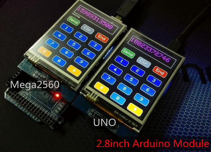

On the number pad, I press "1" and it will register the number 3" and vice versa, however, the numbers in the center of the pad work normal, so It could be the Y or X axis are reversed.
I attached a picture of the number pad to give a better illustration.
I'm using a Kuman UNO R3 2.8 inch TFT and an Elegoo MEGA 2560 R3 Board

Go on. I can't believe humans can ever understand stuff like this:
 if (p.z > MINPRESSURE && p.z < MAXPRESSURE) {
    // scale from 0->1023 to tft.width
    p.x = map(p.x, TS_MINX, TS_MAXX, tft.width(), 0);
    p.y = map(p.y, TS_MINY, TS_MAXY, tft.height(), 0);

Surely it is more intuitive to calibrate in terms of TS_LEFT and TS_RIGHT
and then say:
    pixel_x = map(p.x, TS_LEFT, TS_RIGHT, 0, tft.width());  //map left->right as 0-239
    pixel_y = map(p.y, TS_TOP, TS_BOT, 0, tft.height()); //map top->bot as 0-319

My main point was to say that TS_MINX is a silly concept.
You want to think about LEFT and RIGHT. Sometimes LEFT will be less than RIGHT. Other Touch panels might have LEFT more than RIGHT.
You want to map LEFT and RIGHT to pixel X coordinates. You just put in your calibration values and the map() fuction does the correct transformation.
