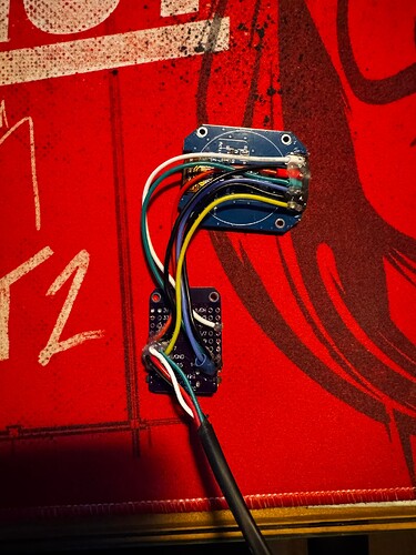

Here is the wiring diagram and a picture but to be honest, I don‘t think that you will see anything because I secured the soldering with hot glue, because the wires are cramped up in a tight space and I don’t want them to whiggle around that much.
You are correct! The bottom sides of the boards, showing the soldering, is what needs to be shown. Check for solder bridges, cold or incomplete solder joints, etc. and use your multimeter to check voltages on all pins.
Especially make sure that you are not applying 5V from the OBD-II TX to a 3.3V input on the MCU.

Power is working fine and before hotglueing the soldering joints I checked for soldering bridges. I don't have a multimeter :grimacing:
But does the wiring looks fine to you?
I mean the problem isn't solved yet, but thanks already for all the help! :handshake:
