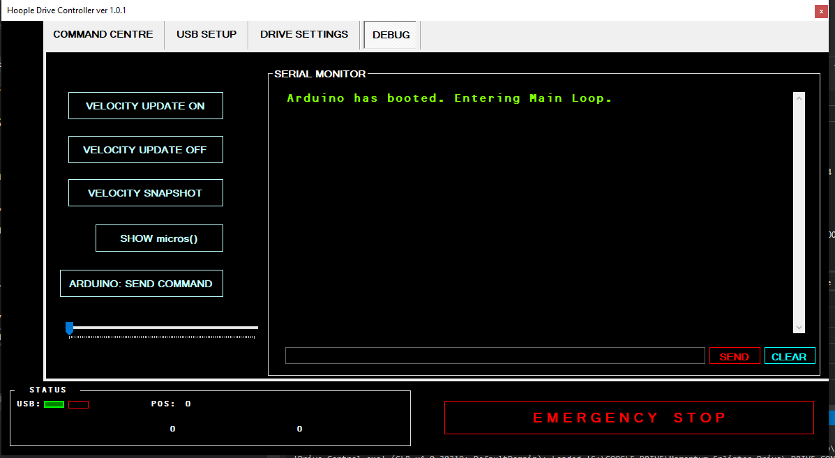

So, I owe you beer or something, Koepel.
I kept coming back to this thread to defend my use of the while loops, because I was 'working on other more important code in my super secret precious source file', and 'I hadn't taken the time to learn UI fundamentals and serial packet protocols yet,' and you know.... the usual, yadda yadda yadda... poor me, computers are hard.
Then I came here to make another excuse, because interfacing with my Arduino through the serial monitor sucked and I had nothing better to do than hope the .ino would grow a magical working UI, and as I read your reply again, I remembered the golden rule: if I wanted it my way, I needed to suck it up and learn how to make it, so with a small pool worth of coffee, I did. And oh boy, am I glad I finally did.

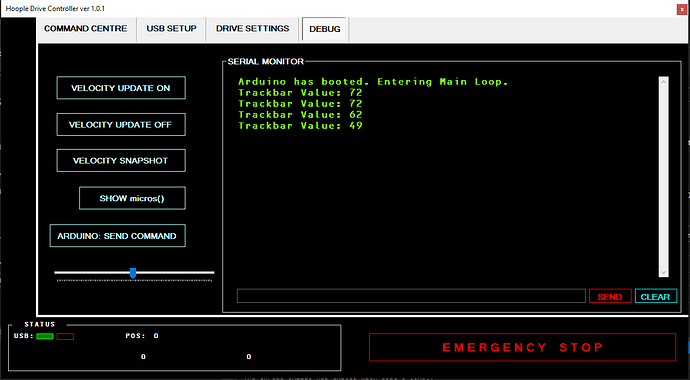

I just threw all that garbage out, and completely rebuilt from the ground up (over and over again as I graduated from shitty quick tutorials to eventually referencing the actual reference materials) Now, it's using some quick conditional branching to read a serial byte, only when available, construct it, only when new, and set a command flag only once it's complete. The actual commands are now handled by conditional branches, which are only tested if the command flag is set. So, my main loop is never tied up in anything, and it's amazing. My eyes hath been opened!
Now I've got all of my command coming from my C# Windows GUI, and because I took some extra time and developed a simple protocol for command codes and values on both ends, I have retained a functional serial monitor for output if I need it. Lots of work to do yet, but finally getting this down feels a lot like getting the saddle on the horse.
