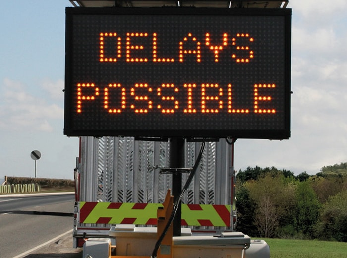

Hello there,
I would like to create an LED sign, powered by a solar panel and using bright yellow LED lights; the type of which are normally found on solar powered road signs (like the one in the attached picture).
Does anyone know what type of LEDs lights they use? I reckon it should be something that consumes very little electricity.
I am planning to have 2 or 3 lines of text (each up to 24-ish characters per line).
The sign would only work during the day and only come up every 30secs or even minute.
Thanks a lot for your help!
I'd revisit that assumption given the size of the light base and that it is full of batteries, possibly lead acid.
As for type, depends on your application.
Would it be "exactly" as shown for example.....
Any Led visible in daylight at whatever distance you have in mind should suffice.
You also need to include in your calculations how long it will be on.
Time it will be off is irrelevant to power consumption.

It doesn't have to be like the one referenced and it would be great if it would be visible at 6-10mts-ish.
The reason I mentioned the low consumption is because the brochures that describe those portable road signs all seem to mention their lights are 'Ultra low current draw'.
I've found these modules from China, where the LED lights are incorporated in a matrix, which could make them easier to arrange, power and control: P31.25 waterproof led display module for variable message sign
The datasheet mentions a power consumption of 12.5W per sq/mt.
The sign would have to be on for 8-10hours a day at max.
I'll do my calculations and will send another message :slight_smile:
