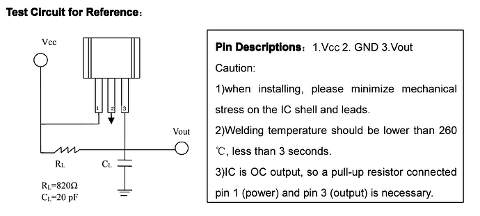

I want to know how to use them with Arduinos. I have no specific project in mind, this is simply trying to learn. I have connected one OH137 and an LED in the following way

Great, but do you understand why INPUT_PULLUP was needed?
As I understand it it it forces the default state to be high or low to make the input easier for the Arduino to read

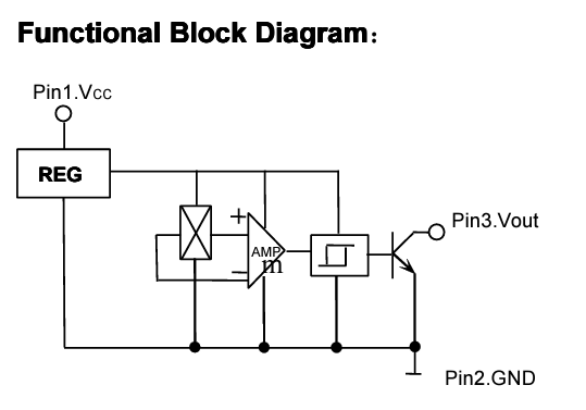

It is because the sensor has an open collector output.
You need to provide a path for the collector current to flow to get a HIGH or LOW voltage response from the sensor.
In fact if you still have some switching instability you could add a 10K or lower pullup resistor.
Thanks, nice explanation!
I tested out the sketch with the hardware yesterday, and it was totally stable, so it looks like the resistors aren't essential, however I may try it again today with the resistor to see if there is any difference. Would the resistor also potentially improve reliability?
