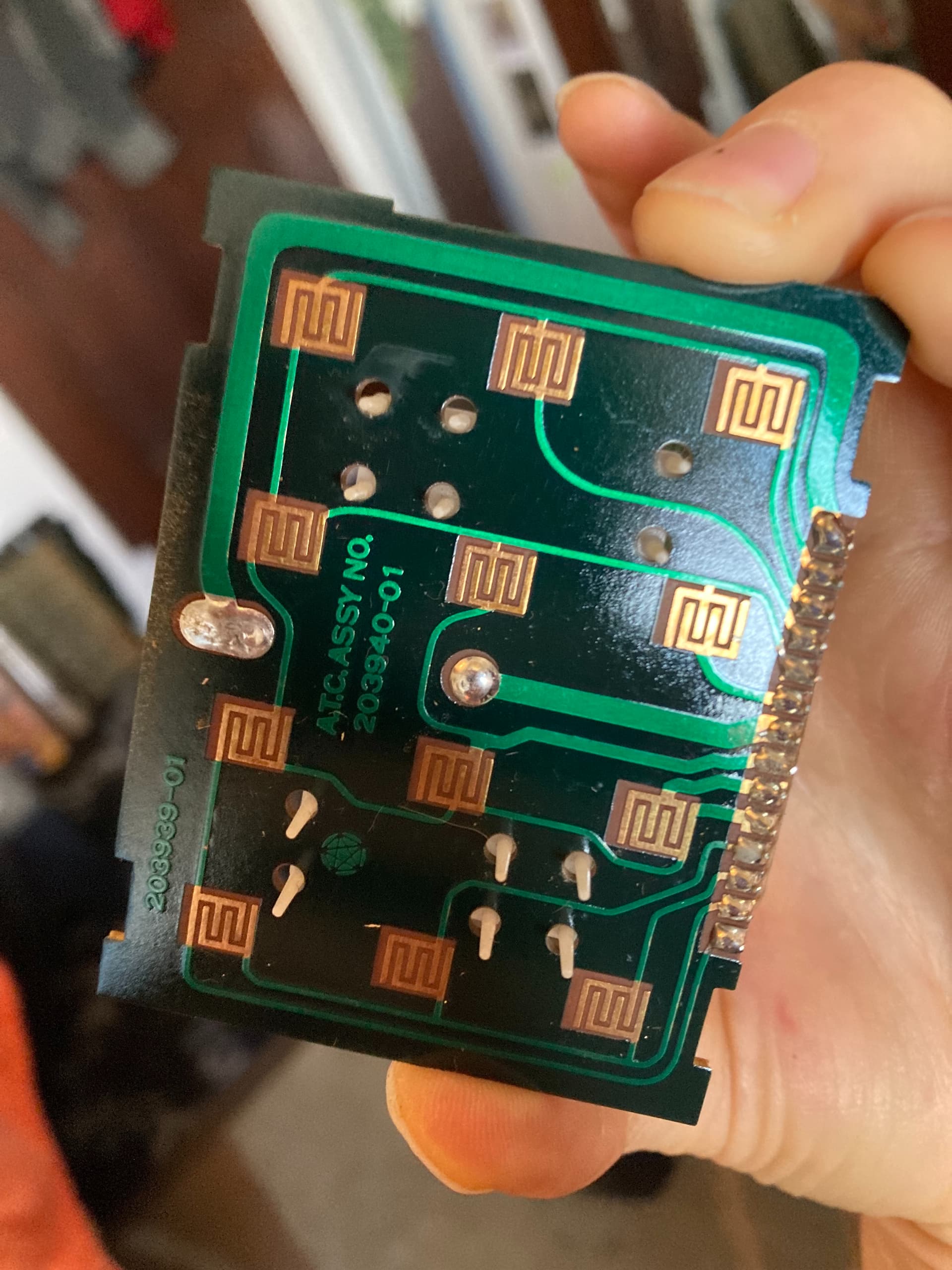

Sounds like the item has active circuitry inside. Post pictures of the front and back of it.

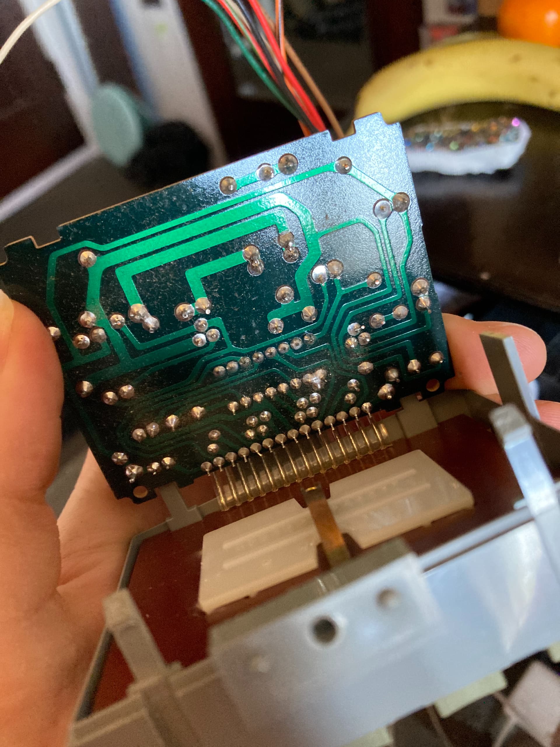

Here it is.. yes looks a bit different inside...
That is a complete DTMF tone generator, with keypad. I'm sure that the circuit is posted somewhere, and the IC is standard.

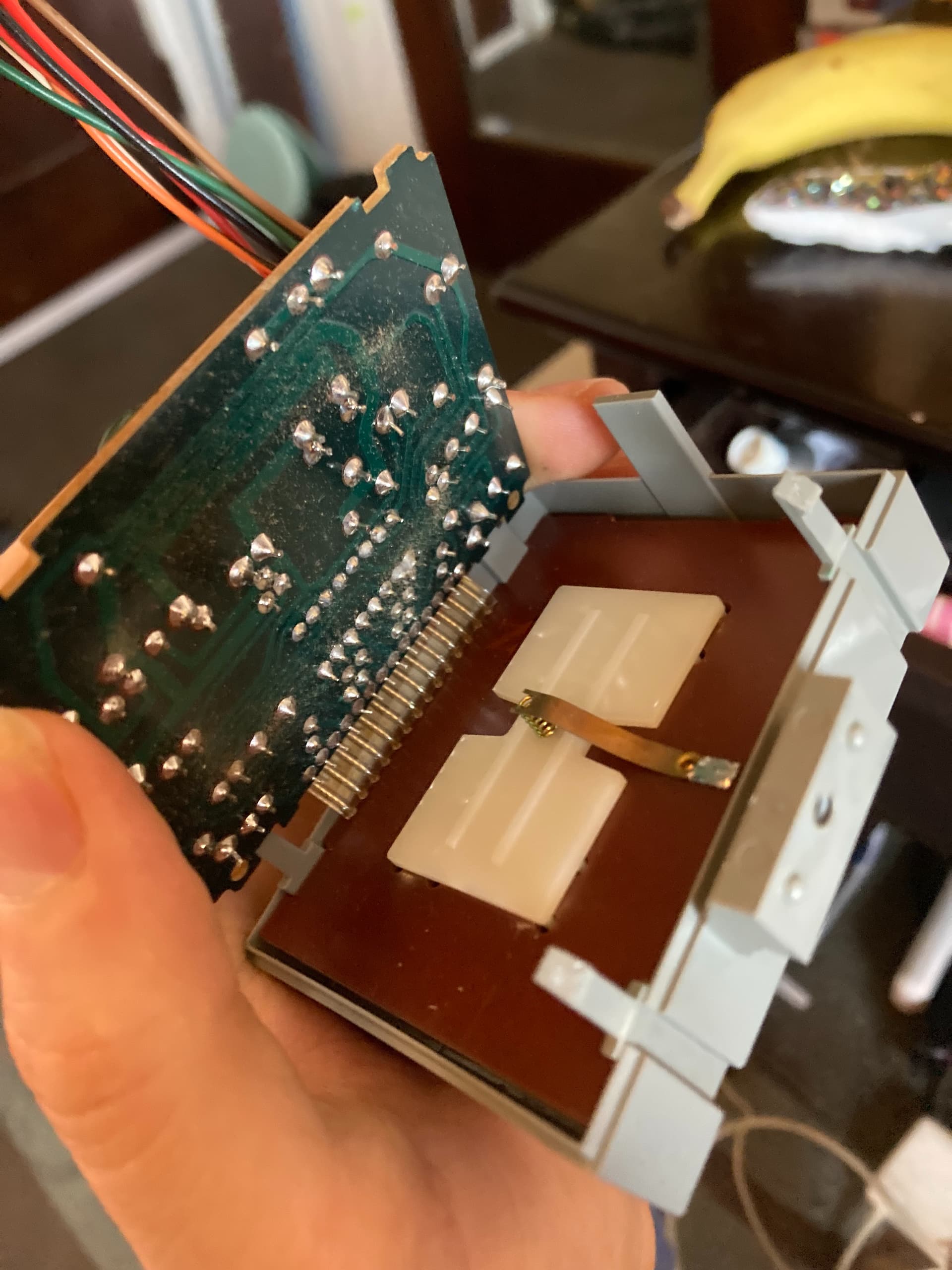

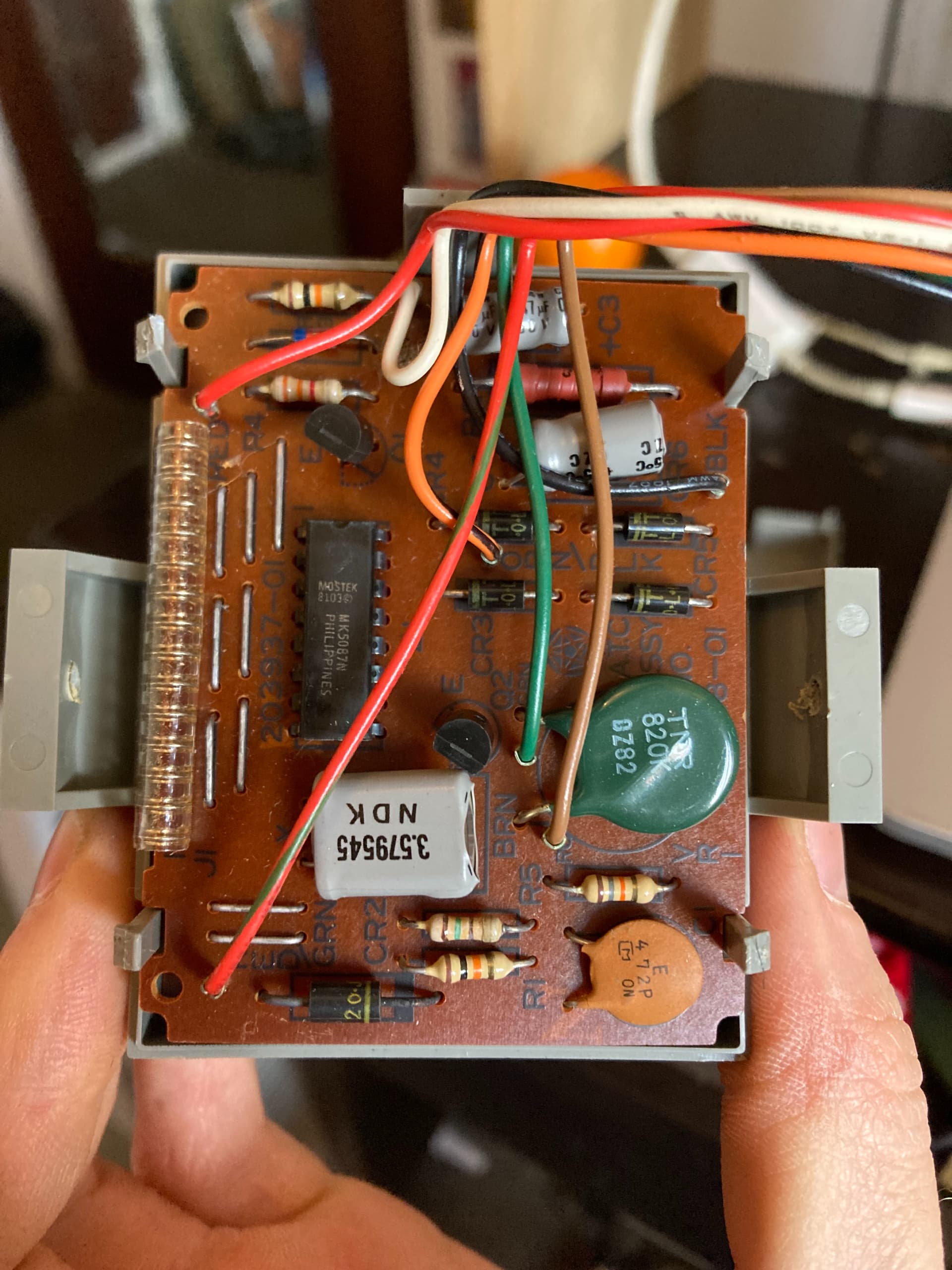

and the front

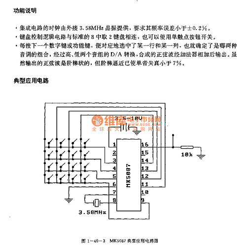

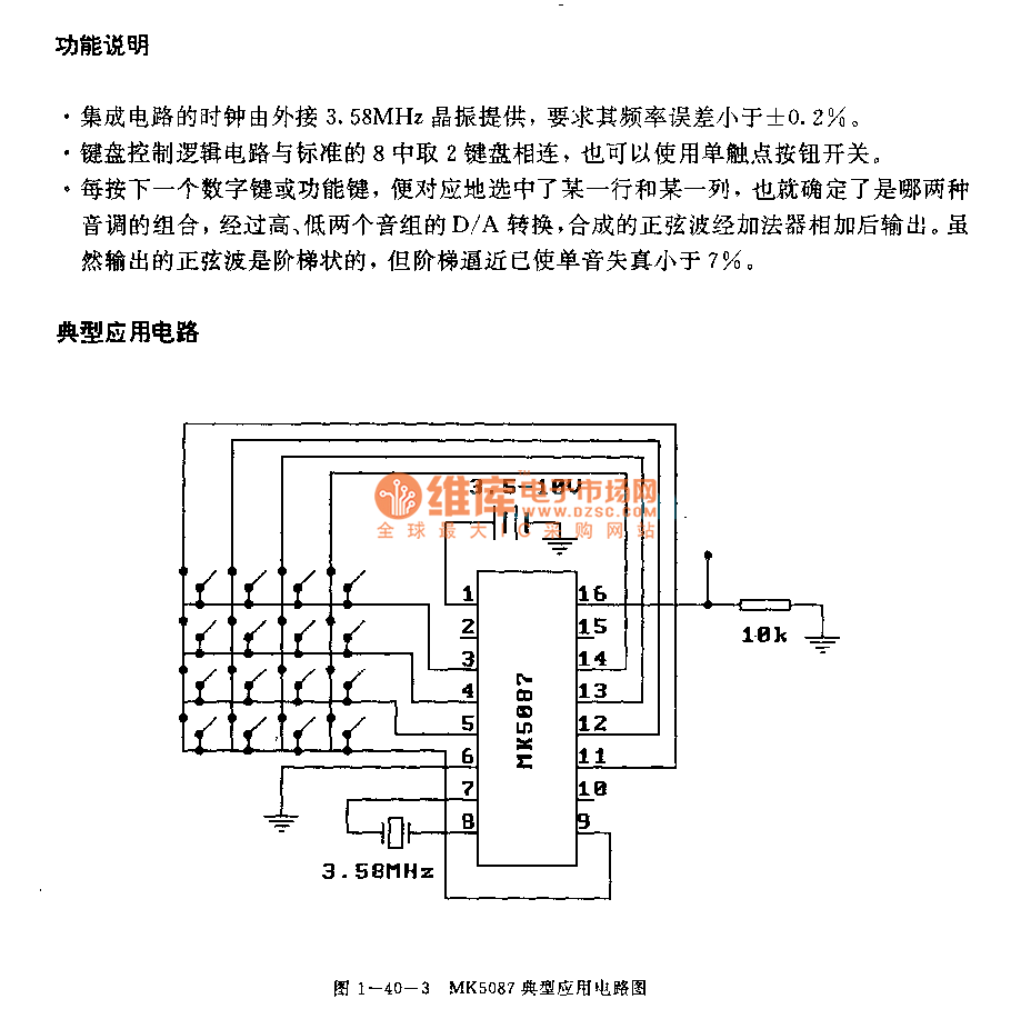

It looks like your phone uses the MK5087 CI.

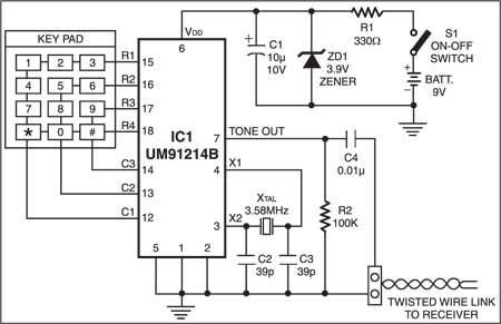

See this schematic:

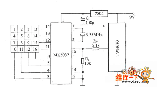

The circuit will look something like this, but powered from the telephone line rather than a battery (from https://www.electronicsforu.com/electronics-projects/multiple-appliance-keypad-control)
Thanks for the responses! I'll try and figure out how to interface the button connections with the arduino. Haven't quite wrapped my head around it yet, but as an initial question do you think I'm better off bypassing (if it's even possible/easier) the MK5087 and the other circuitry and try to just interface the pins coming straight from the keypad with some kind of pairings similar to the other row/column posts? thanks
You can use the keypad by itself, but the contacts probably have fairly high resistance.
The buttons press a rubberized carbon disk onto the naked, E-shaped PCB sections, so you might find 10K to 100K Ohms resistance between keypad leads, when a button is pushed. Let us know what you measure.
If the PCB button contact traces are oxidized, it might help to clean them with a rubber pencil eraser.
Ok just finding pairs off the keypad itself seems to be working! It's measuring about 33-40ohms so far for the pairings! Many thanks for the help, it sounds like I can just send the appropriate pins directly in the arduino GPIOs and do the logic programmically then?
That should work well. The contact resistance is lower than I expected (based on experience with a similar keypad from a calculator). Did you clean the PCB pads?
