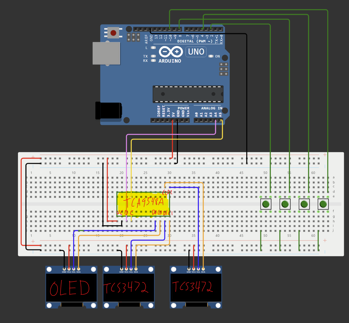

Hi there, I am working on a project to display color reading values to an OLED display. I am using an Elegoo uno r3. I have this connected to a TCA9548a multiplexer. Connected to the multiplexer are 2 color readers (TCS3472) and a 0.96inch OLED display.
The display works when I connect it via i2c to just the arduino A4 and A5, and the color readers work as well, both by themselves and at the same time in the multiplexer.
The trouble arises when I have now connected the OLED to the multiplexer as well, and I can't seem to get anything to display on it.
I'll include the whole code of my project, the majority of it is controls to navigate between menu screens on the OLED, and those all work when I tested just the display. But now with the multiplexer no dice. So I'm thinking problems arise around line 134 when I try to begin the display but I'm unsure.

Adafruit_SSD1306 display(SCREEN_WIDTH, SCREEN_HEIGHT, &Wire, OLED_RESET);
Adafruit_TCS34725 cs1 = Adafruit_TCS34725(TCS34725_INTEGRATIONTIME_50MS, TCS34725_GAIN_4X);
Adafruit_TCS34725 cs2 = Adafruit_TCS34725(TCS34725_INTEGRATIONTIME_50MS, TCS34725_GAIN_4X);

void tcaselect(uint8_t i) {
  if (i > 7) return;
  Wire.beginTransmission(TCAADDR);
  Wire.write(1 << i);
  Wire.endTransmission();
  Wire.begin();
  pinMode(btnLeft, INPUT_PULLUP);
  pinMode(btnRight, INPUT_PULLUP);
  pinMode(btnSelect, INPUT_PULLUP);
  pinMode(btnReturn, INPUT_PULLUP);
  delay(100);  // Add a short delay
  tcaselect(0);
  if (!display.begin(SSD1306_SWITCHCAPVCC, SCREEN_ADDRESS)) {
    for (;;)
  display.clearDisplay();
  display.setTextColor(WHITE);
  drawWelcomeScreen();
  tcaselect(1);
  if (!cs1.begin()) {

And I've uploaded a schematic of what is set up currently.
Does the TCA9548 seen on the I2c bus with i2c scanner? On which address?
Maybe lack of pullup resistors on the OLED?
Check the voltage on the SD1 and SC1 pins. If not close to 5v, then it needs pullup resistors.
Edit: Make that SD0 and SC0 pins. If not close to 5v, then it needs pullup resistors.
You do not have enough memory, the compiler shows 933 bytes of ram used, the display buffer will use another 1024 bytes at run-time, leaving only 91 bytes for the stack, local variable, etc.
There are other display libraries that take less memory, either the U8g2 library using a page buffer, or the libraries that only display text.
Yep it shows up at 0x70
Then the connected components also show up at their expected addresses.
0: Found i2c 0x3c (oled)
1: Found i2c 0x29 (color reader)
2: Found i2c 0x29
Try one OLED, compile, then two, compile... look for signs.
Hey thanks for the response, I think it has internal pullup resistors. And measured voltage is hovering right around 5v
Regardless, tried a pullup and no dice with that!
This seems to have been the issue! Switched to the U8g2 library and now it works a charm, thanks for the insight!
