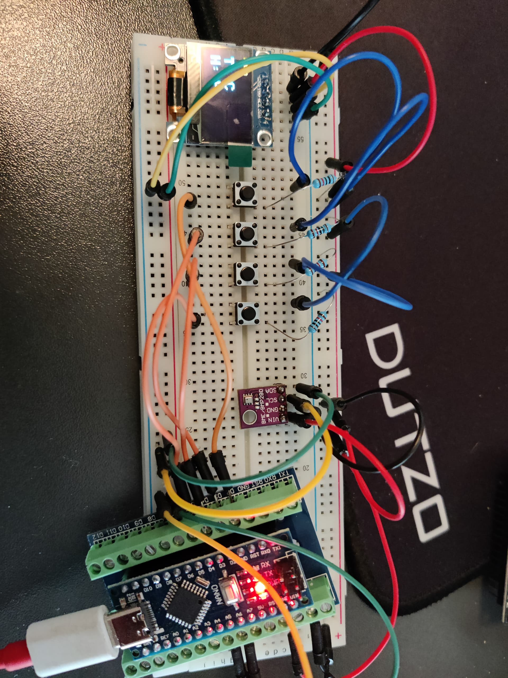

Hello,
I'm trying to create a little room temperature sensor with a OLED display.
I'm using a:
Arduino Nano
BMP280
OLED, SD1306
My menu function and push button works fine, but when I try to add the BMP280 to the code, my OLED fails to initialize, and I get the serial print "SSD1306 allocation failed".
As you can see I also tried to add a delay before initializing the BMP280, which didn't do any difference.
I also tried to initialize the BMP280 before the OLED, but this didn't help either.
When I run the below code with all BMP280 stuff commented, the sketch runs fine.
But if I just try to remove the comments for the initializing of the BMP280 I get the error in the serial monitor, and the display is not initializing (the code compiles fine).
I tried running this sketch, LINK, which works fine (with adjusted addresses). So I conclude my BMP and OLED can work together.

Please, show the picture of the BMP280 Breakout board that you are using.
The Adafruit_SSD1306 library tries to allocate 1K of RAM at runtime. There isn't enough RAM left over for it to do that. That's what the allocation error means.
You can try enclosing any character strings used in print or println with the F() macro to avoid making copies of them in RAM. That would save you over 300 bytes of RAM. That might be enough to get your sketch to run. If it's not, you'd have to investigate an alternate library that doesn't allocate that 1K screen buffer, like SSD1306Ascii. You'd have to rewrite parts of your sketch to accommodate it.
Hmm okay.
But how come the other code works then? it also uses 703 bytes, "only" leaving 642 left?
So considering, i'm planning to add more functions to this, I should consider using another microcontroller?
