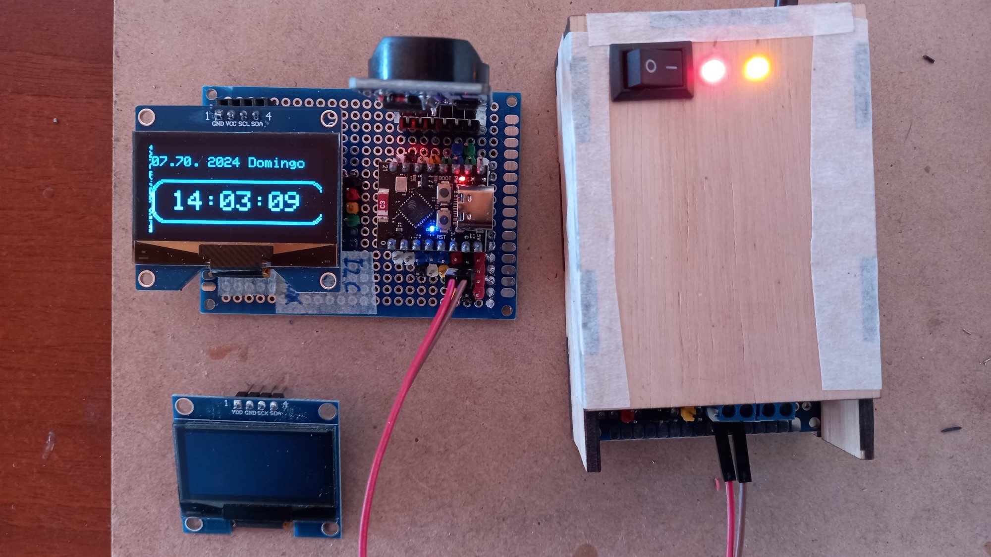

OLED SH1106G random pixels at the left border
Hi everybody,
I have a strange behavior on a 1.54" OLED Display which on other ones does not appear:
same code, just plugging in a 1.3" OLED :slight_smile:
The code loaded on an ESP32C supermini is this one:

the display is not broke, I can reproduce the issue on another one of the same type.
the effect appears only using the Adafruit library, with other libraries the respecting examples work fine.
Any idea what this is about ?
Are you certain the display uses an SH1106G and not an SSD1306?
yes I am definitely sure, actually I changed the library to use a SSD1306 and got all scrambled.
plugging a SSD1306-OLED and start the code with changed library again works good. I made this little board to test different OLEDs
Do you get the random pixels if you run the Adafruit SH1106 example sketches?
Maybe a SSD1309... but I think a SH1106G without the 2 bit offset is more likely. Look in the library's begin() method and comment out the assignment of _page_start_offset near the start and see what that does.
Slightly off-topic, but why are you using an RTC with an ESP? You don't need one.
yes, the same effect with the Adafruit examples
Sounds like a problem with the Adafruit library. And the problem occurs with their example code. Sounds like you should report this on the Adafruit forum.
...that´s why I like this forum so much, in less than 1 hour I got the solution :slight_smile:
I found this variable _page_start_offset and set it to "0" and it works with the 1.54" display.
However now the effect appears on the right edge of my 1.3" display.
Anyway, now I know how to handle it and adapt the code to the display I am using.
Thanks a lot Mr. Van Der Decken
my problem is solved,
now - off topic - what do you mean with I don´t need a RTC with my ESP32 processor ?
