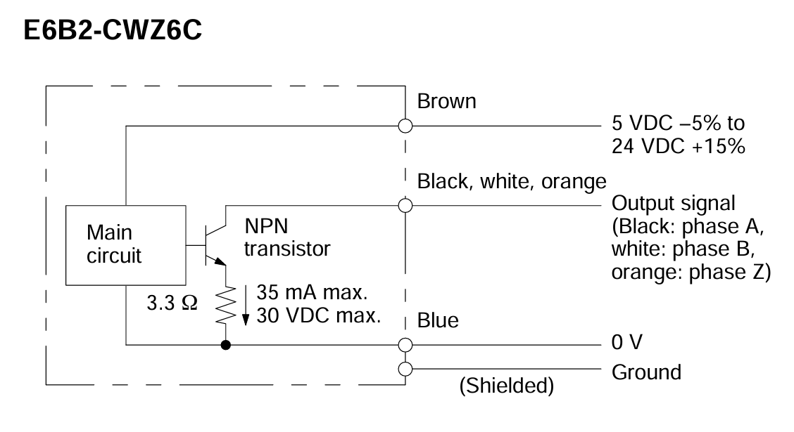

1- Omron encoder 1000P/R (E6B2-CWZ6C)

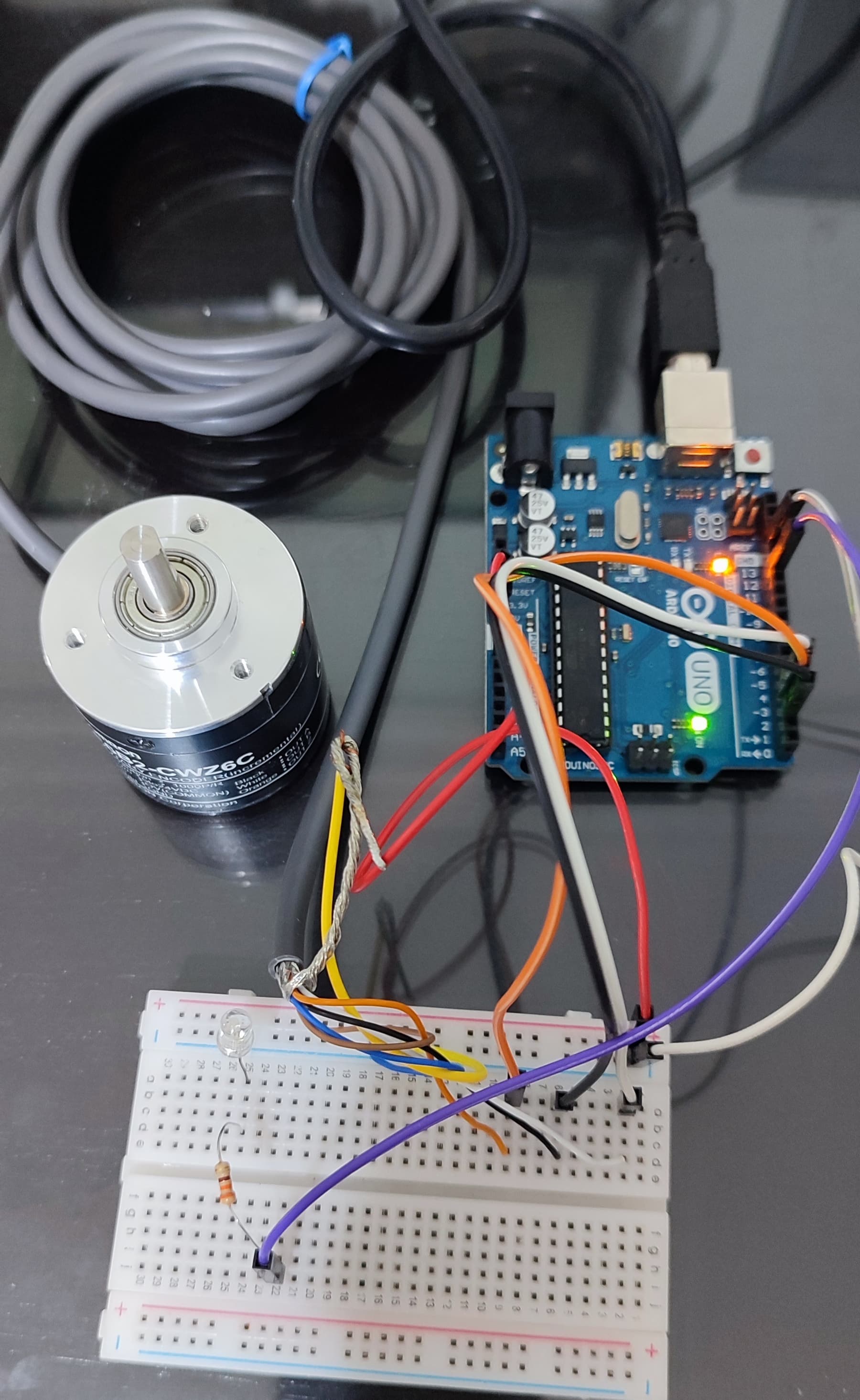

Hi, @mostafagemy
Your encoder.
Connections.
thanks for you all, the connections are shown , and i modified the code for the next step, but still the led is not blinking at each rotation and its status in serial monitor is on for whole the rotation and off for whole the next rotation, and i want it to only blinks when single rotation is completed , i will also add camera to take a picture but not included yet.
