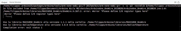

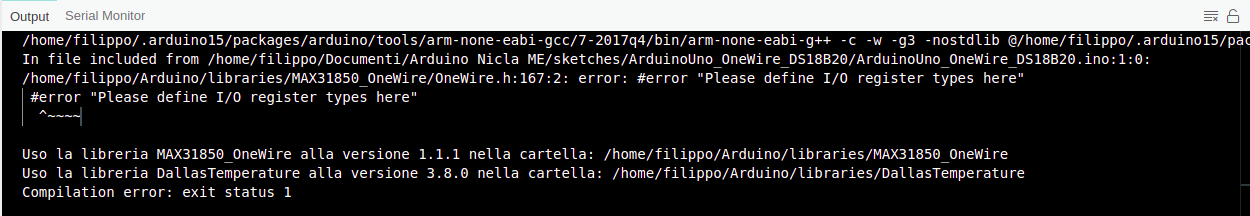

COMPILING ERROR:
I have read on several forums that it is a compatibility problem between library and NiclaSenseME board! in fact, even the Arduino technical support confirmed it to me!
if you need more information...tell me again!

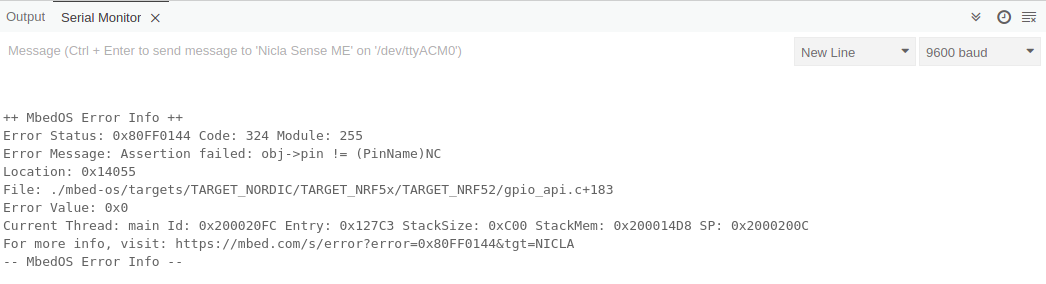

Results:
Compilation and upload are OK!
But when I open the Serial Monitor:
Thanks
