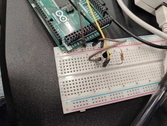

Hello, I am new to Arduino. I am using the temperature sensor of DS18B20 to try to read the temperature by myself. After reading the article Using DS18(B)20 temperature sensor with Arduino, including using it with the nuElectronics Datalogging Shieldhttp://sheepdogguides.com/arduino/ar3ne1tt.htm), I used the above code to get 85 and -0.06 got the wrong temperature, can you guys please debug this? Because I read this article, it seems that this code can be used.

**********************************************************************************And for the schematic, I using the mega2560, GX18B20, and 4K7 resister, there is a photo of
how can i connect them, by the way when I use the One_wire_bus library and DallasTemperature library the data looks good, so connect should be ok, can you guys help me figure it out where I can fix it for code?
Thanks give me a guide. There is my code:
how can I connect them, which is the same for ([http://sheepdogguides.com/arduino/ar3ne1tt.htm)] . By the way, when I use the One_wire_bus library and DallasTemperature library the data looks good, so connect should be ok, can you guys help me figure it out where I can fix it for code?

I connected a DS18B20 sensor to an Mega and uploaded the code from the page that you linked. The code seems to be working fine. I don't know if your sensors, with different part numbers, will work the same as mine.
To which pin is your sensor connected. It should be pin 14 (TX3) to work with that code.
Here is a sample from the serial monitor:
The temperature rise is from heating with my lighter.

Ok...... I am more confused right now..... I copy your code and change it to pin 14(TX3) on the board, and here is what I get:
so that is not my code issue...
Can you heat or cool the sensor to see if the output changes?
Yes, I try it, but nothing happened, it always stays at 85, and on the code website, the author has this:" Information: If your sensor returns "85" (degrees C), it is "saying" "Something is wrong." (85 is a rogue value)"
Something wrong but I did not where is the problem.
