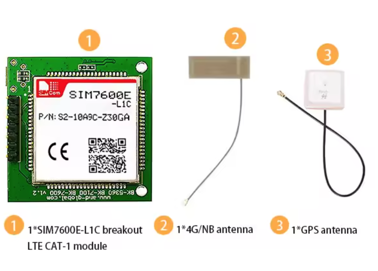

Hello everyone. I am working on a GPS remote tracker sending data through 4G. I bought an article from Aliexpress including the following 3 components:
As you can see, other than the 4G and GPS antennas, it has the sim7600 module core board (indeed the article name is "Original CAT1 SIM7600E-L1C breakout,4G LTE core board 1pc"). However, it seems that I cannot safely connect to Arduino UNO using only it (chatgpt), and that I need some sort of extension. This is what I've seen in most tutorials:
Is there any way I can connect safely to arduino UNO using only the core board, or do I need some sort of extension? Are there any cheaper and valuable alternatives to sim7600?

Do you have a datasheet for the things you bought?
In the pics of what you bought from AE, I don't see a GPS module, only the antenna.
Use the writing (upside down) on the bottom edge of the SIM module to get the pinojut of the board. It looks like maybe 8 pins.

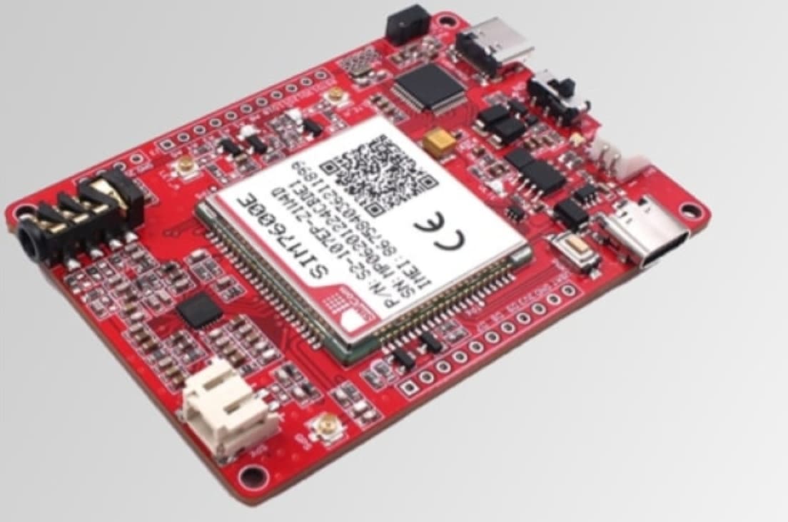

That picture of the RED board is very different. It does have the same SIM, but also many, many, many more components and connections. Which of the two do you think is potentially workable?
rather than photos links to the original web page where you purchased the modules would be more useful
the probability is that the modules use 3.3V logic
if so do not connect directly to a UNO which uses 5V logic
use level converters or even better move to a microcontroller which uses 3.3V logic, e.g. ESP32, RP2040, STM32, etc

I see that the red one has many connections, I just need to send data through for 4G to a webserver.
