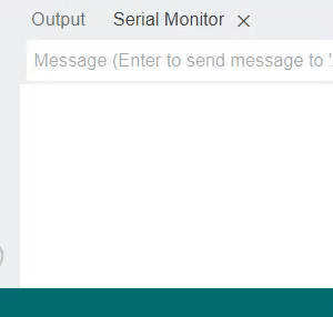

When I run the code on the esp32, this comes in the Serial monitor:
gif1
I expect to receive the numbers on the Uno like this, but instead I get nothing.
But when I unplug the esp32 it does this:
gif
It just prints all the data that is send.

I got it like this
It's kinda both. So when it is connected to the breadboard power supply, it has a button where I turn it on and off.
But the same problem occurs when the esp32 is unplugged from the usb-c.
And you're right because it is a bit confusing if I keep switching the statements.
