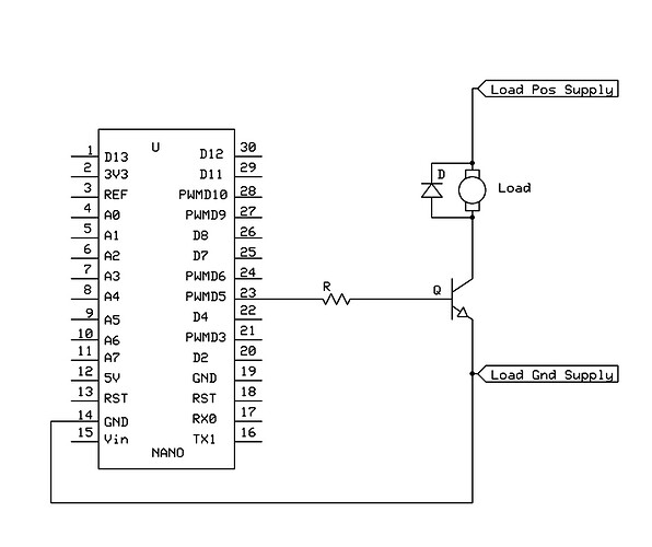

Active buzzers can be driven like a relay.
+Batt to +Buzzer.
-Buzz to the collector of an NPN transistor (2N2222 or similar).
Emitter of the transistor to Batt- and Arduino ground.
Base, via a 1k resistor to a digital Arduino pin.
A small diode (1N4148) can be added across the buzzer, to protect the transistor against inductive kickback.
But probably not required for a piezo buzzer.
Leo..

Can you draw your circuit and include your Arduino and how you have it all powered up please.
What model Arduino are you using?
Simulator diagrams tell us very little of your project wiring.
If all you want to do with the 5V Arduino output is switch a 12V buzzer on and off then something like this will do;
Does this help you out? I am using an Arduino Uno.
