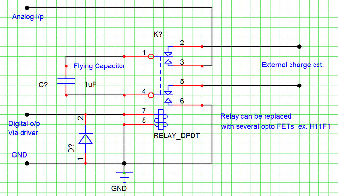

You could use a modified version of the flying capacitor circuit.

I'm a little unsure of what this circuit even does. Sorry for being a noob, but I'm not seeing how I could implement it.
In this case it is good for only +o/p voltages.
Basically when the relay (or fets) is/are de-energized the 1uf capacitor is charged by your temperature o/p cct.
Then the Arduino energizes the relay and the capacitor is transferred to it's analog i/p where it is converted.
The temperature cct. is never connected to the Arduino.
