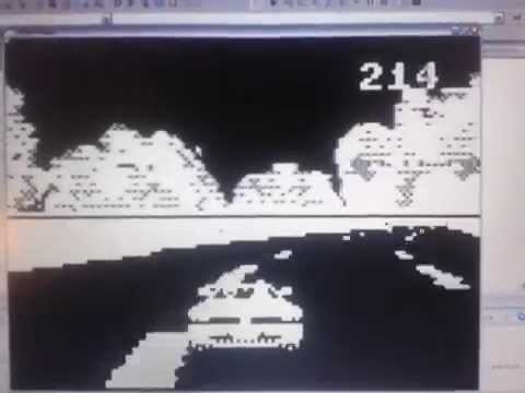

I was playing around with a home built Hackvision (Hackvision: tiny, hackable, Arduino-based video game system) and became enamored with the idea of making a game on it.
I soon noticed that developing a game on Arduino is quite slow due to the fact, that debugging is so difficult. So, I ported the TVout library to run on SFML (simple and fast media library). Now, I can develop and debug on Code::Blocks with GCC and MinGW, and then take the code to Arduino. When developing a game, this greatly simplifies the development process because I can step through code and see how variables and memory locations change (very handy for debugging bitshifting algorithms) .
Here are work-in-progress videos of the project

Latest update brings roads & curves
