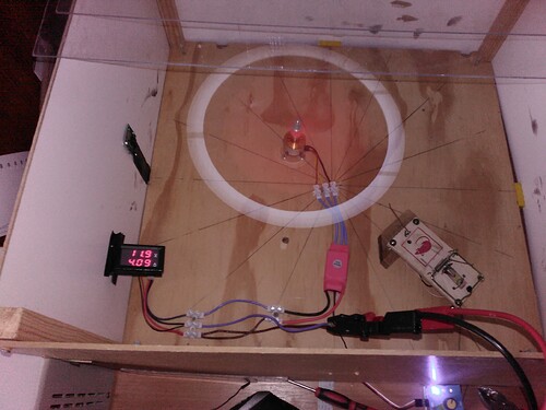

In below photo I did run a KV2700 outrunner motor with 11.9V at 4.09A with a Simonk 30A ESC.
But I measured "only" 4082rpm with reflective material on one blade and laser tachometer.

That propeller is far too large for a small 2700Kv motor so that will be slowing things down.
But I suspect the main thing is that you don't have nearly enough power feeding the ESC. Something is limiting the current because I would expect it to be much higher than what you're measuring. More like 40A (until everything burns out) than 4A. Exactly what battery or power supply are you using?
Steve
As can be seen on photo I was powering at that time with 31V/5A constant voltage power supply.

Small correction, did power with 150W/12V mains adapter that day. That explains why I saw only something above 10A as the mains adapter can deliver 12.5A only for 12V, but it does not give the reason for the three ESC losses.

If you can see a power supply in that picture you have better eyesight than I have. And 31V is ridiculously high.
Anyway recommended propellers for that motor are something like 120/125mm diameter. With those you are likely to get peak currents around 15-20A on 3S.
Until you try a sensible sized prop there's no real point in wondering exactly which part of the system is going to die first. It could be the motor or the ESC or the battery.
If you really want to use a 255mm (10in) prop then you have the wrong motor. Maybe something around 850-1000Kv might do it.
Steve

You should also know that no motor ever rotates at Kv x V when it has a propeller fitted. You're more likely to get 80-85% of that provided that it's fairly lightly loaded.

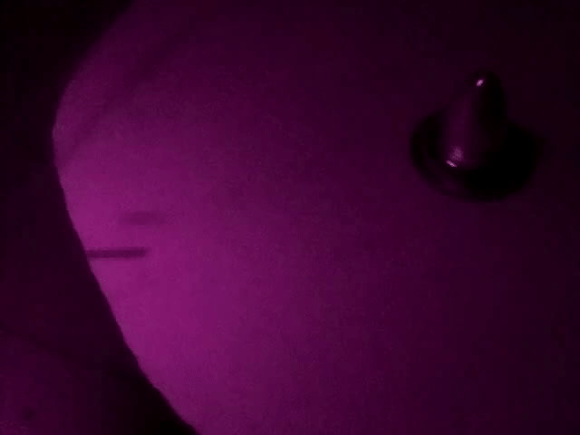

Then I did place Raspberry v2 NoIR camera (with added M12 mount and M12 lens) above the scene.
I tried my 48led IR light and it was good enough to light the scene for capturing with 50µs shutter time
(1000lm lamp was not sufficient).
https://www.aliexpress.com/item/32856122386.html
This was command used to capture 150fps video with 50µs shutter time after propeller was rotating with 12.2V and 2.01A:
$ raspivid -md 7 -w 640 -h 480 -p 22,50,640,480 -t 0 -fps 150 --shutter 50 -o tst.h264 -pts tst.pts
After aborting the recording I did run ptsanalyze tool on generated tst.pts timestamp file. It reported "535 frames were captured at 150fps" with no frame skips.
Finally I extracted frames from the video and created a 13 frame 2fps animation from the repeating pattern found:
The propeller is rotating clockwise, and it has three blades, with one blade having reflective material.
The video is taken at 150fps framerate, and would stand still for exactly 9000rpm speed.
But what you can see is that propller reflective blade always does a little less than one full round.
If you follow the animation you will see that it looses 2 rounds per 13 frames.
Total rpm less than 9000rpm is therefore 150/13260=1385, resulting in 9000-1385=7615rpm.
This is nearly a perfect match for the 7635rpm measured with laser tachometer!

Here you can see a run powered with 12V/6A, slightly more than 17000rpm or nearly 300 rotations per second, with 123mm diameter more than 100m/s speed! Because of the high speed and v2 camera rolling shutter effect the reflective marker now looks like a thin line. And the outrunner motor bullet heavily shakes. Again animation plays at 5fps, 30× slower than real:
Finally I did measure between 1A and 10A again for circular disk. I did leave out 8A and 9A because I am really happy with 10A rpm reading, and because of the stress those runs are for Simonk ESC that gets hot:

Here is the updated diagram -- I will not even look at propellers anymore for my high rotational speed experiments, 0-pitch circular disk is the way to go for highest speeds:
New speed record achieved again with 21591rpm for 12V/10A, 139m/s(!) or 501km/h(!!):
$ echo "pi=4*a(1); scale=2; 0.123*pi*21591/60" | bc -ql
139.05
$ echo "pi=4*a(1); scale=2; 0.123*pi*21591/60*3.6" | bc -ql
500.58
I was first surprised that the thin cardboard could stand the massive forces, the disk rotates with 360 rotations per second.
I was surprised as well that the imbalance shown in the fast rotating animation did not do harm to the disk and just works. As you can see in the animation the line and dot that can be seen on motor test station ground plate in lower left remain completely in place. Only the 6cm high wooden bar superglued onto ground plate, the outrunner motor is firmly screwed into, shakes.
With new 240W transformer and new 50A digital amperemeter on weekend more amps tests can be done to see where the speed limit might be. And I already did draw a 160mm diameter circle on the remaining piece of blue cardboard I have, need to cut that out and see what rpms and tip speeds can be achieved with 10A for that disk ...

I captured photo of amperemeter/voltmeter at maximal speed:
Doing the VKV math gives 11.7V2700KV=31590rpm -- that is 2000rpm less than the measured 33533rpm!

I did upload 150fps slowmo of 33533rpm run to youtube, and that shows only minimal movements of outrunner motor bullet top:
I remembered that I have two v1 cameras installed at different side borders inside motor test station. I replaced the camera on front inside by a v1 NoIR camera after I realized that the camera lens was exactly on height of circular disk on outrunner motor. I typically place Pi ZeroW outside before motor test station to allow capturing when needed. Its camera cable connects to a Raspberry camera cable adapter (left of ESC tester that controls the outrunner motor) that is connected to v1 NoIR camera on the inside:
I took a raspivid video with 50µs shutter time again, this time with 90fps framerate because that is the maximal v1 camera framerate. I powered the outrunner motor with ESC tester from stand still to maximal speed of 559rps, kept that for 10s and then slowed down to stand still. With 559rps, a full rotation takes slightly less than 2ms, and circular disk does slightly more than 6 rotations between successive frames. I did capture timestamps, and did run ptsanalyze just on the 99 successive frames in the middle of high speed phase used to create below animation, covering 1.1s of the video. No frame skips, and all frame deltas in 10µs wide band:

The animation is played at 3fps, 30× slower than real. Because the frames were nearly completely dark I took a raspistill image with same 48led infrared lighting used to record the video. Room window shutter was closed, room completly dark. I did cut out the active part from the frames and did overlay onto the raspistill image, and created animated .gif from that (only 260KB size). What you can see is that outrunner motor bullet keeps its position completely despite rotation with >150m/s. What I find interesting is that the circular cardboard seems to be not that flat as I would have thought. Forum software scales the animation down a bit, right click in order to see it at original 640x480 size:
