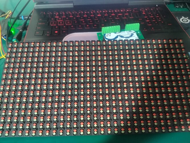

Hello everyone, 2 days ago I found a P10 led display:
Then I connect to a UNO board and use simple code to run it and this is a result:
Where did I do something wrong?

The problem is probably in your code, or just possibly in your circuit but how would we know ?
Sorry I forgot to up the code:
#include <SPI.h>
#include <DMD2.h>
#include <fonts/Arial_Black_16.h>
SoftDMD dmd(1,1);
// Number of P10 panels used X, Y
DMD_TextBox box(dmd, 2, 1, 32, 16);
// Set Box (dmd, x, y, Height, Width)
dmd.setBrightness(200); // Set brightness 0 - 255
dmd.selectFont(Arial_Black_16); // Font used
dmd.begin(); // Start DMD
dmd.clearScreen();
box.print("LED");
I am not familiar with the library but a wild guess would be that you need to use a font that is not black
Have you tried a different font ?
What's you mean as "not work"? That the picture is inverted or something else?
The library has an invertDisplay() function but I am not clear as to whether it turns the display upside down or inverts the colour of the display
Try it and see
the latter
