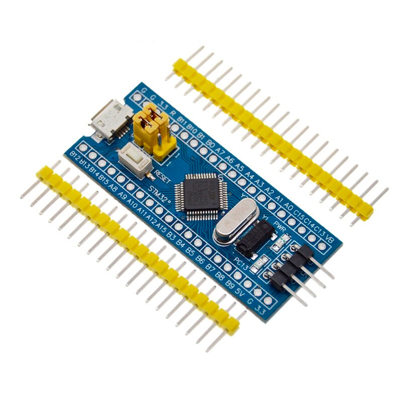

Most arduino projects with stm32 family controllers were created on the so-called "bluepill board" - stm32F103C8T6
You may be more comfortable using Raspberry Pico RP2040-based boards as it is better supported by Arduino IDE.
