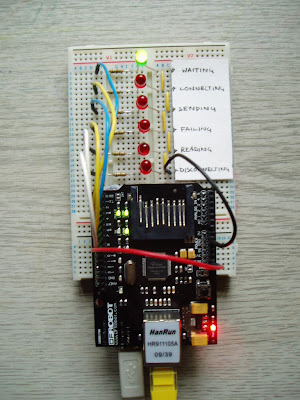

I've got a reliable PUT but not a GET - I've found that the code on the Pachube site doesn't survive a router re-connect - it goes into a continuous loop without connecting again. That's why they have to use the watchdog. I've managed to solve this without having to modify the boot loader.
Let me know if you need this code.
Exellent. Yes please, i would love to see your code
Here's the code I've been testing and my board - It's been very reliable and can survive disconnection of the Ethernet cable, router re-connect and also power disruption if you bend the pin out on the Ethernet board and connect one of the digital outputs to the reset pin. I used a piece of wire.
I've added a series of LEDs so I can see the system state when it's running from the power supply.

Here's a picture of my test board
Thanks a lot, neat set-up. Please beware that you are showing your api-key...
Oops! I removed the key - thanks. You should be able to convert the PUT to a GET easily enough
