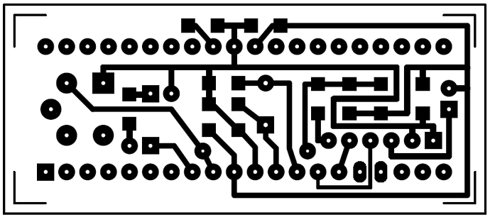

Here is what I was making before Crossroads made his.
Might save you some work.
The attached PDF is a single sided PCB 1X1
Bottom.pdf (10 KB)
Negative
Bottom.pdf (10.1 KB)
LarryD:
Thanks for that Larry. They look good.
I'll save all 3 (and the schematic) for reference, but this is the one I'm likely to use. I avoid double-sided boards wherever possible, and always use positive-acting photoresist. (Kinsten pre-sensitized PCB blanks)
I use a negative, sounds like we should go for coffee some time :slight_smile:

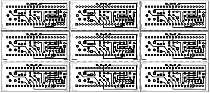

9 single sided Boards:
Edit:
Schematic PDF
Positive PDF added
Bottom.pdf (77.6 KB)
Root_1.pdf (13.8 KB)
