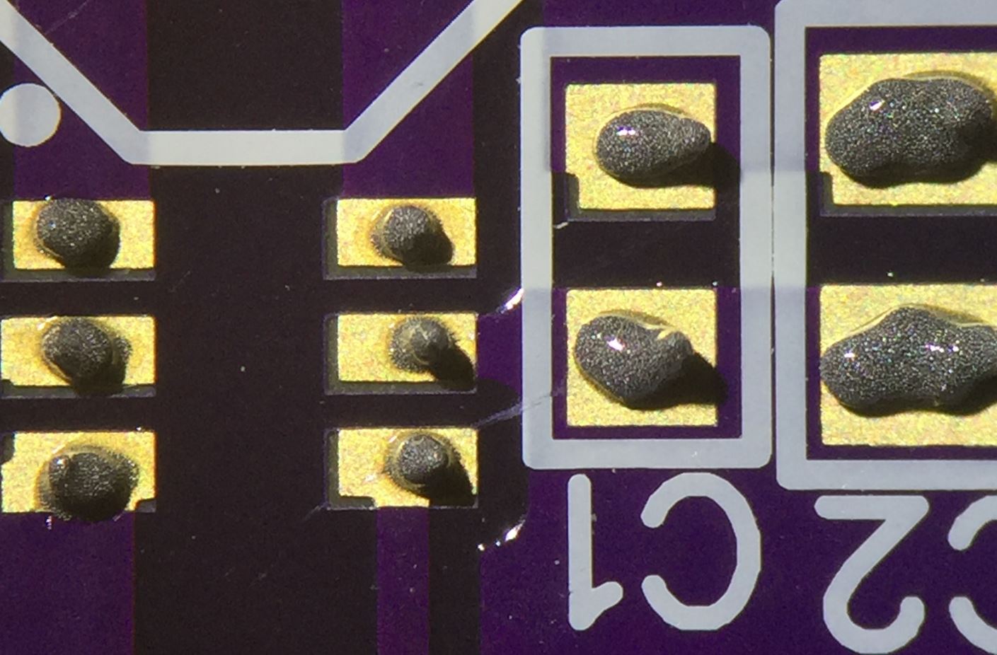

Wanted to post quick update: I ended up buying SE400-Z for $180 and could not be happier, price is great, quality is great, distance from surface to lens is so much I can easily move soldering iron in there. I think after oscilloscope this is my second best purchase for the lab. If we are talking about somewhat lower budget microscope for PCB works, I seriously recommend looking into this one.
I attached some pictures of recent PCB before and after magnification, you can see how tiny one diode is in there. And on other illustration you can see individual solder balls inside solder paste, even depositing solder paste is easier now with regular needle. Very happy.
