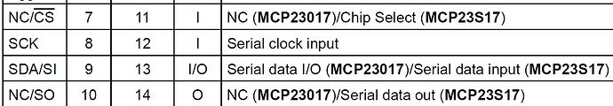

I'm thinking of using it with SPI.
I'm reading the datasheet to know the spi pins for the mcp23017.
But I'm a bit confused between mcp23017 and mcp23S17.
Now, what should I do with the mcp23017 spi pins ? For example, does the mcp23017 require a CS pin or it doesn't matter ? also what about if I want to read data with MISO ?
For SPI, you will need the MCP23S17, not the MCP23017 and you can ignore information that is specific to the MCP23017
If you only have one device on the SPI bus, you can hardwire the CS to GND; but if you ever want to expand with another SPI device (no matter which one), you have a problem.

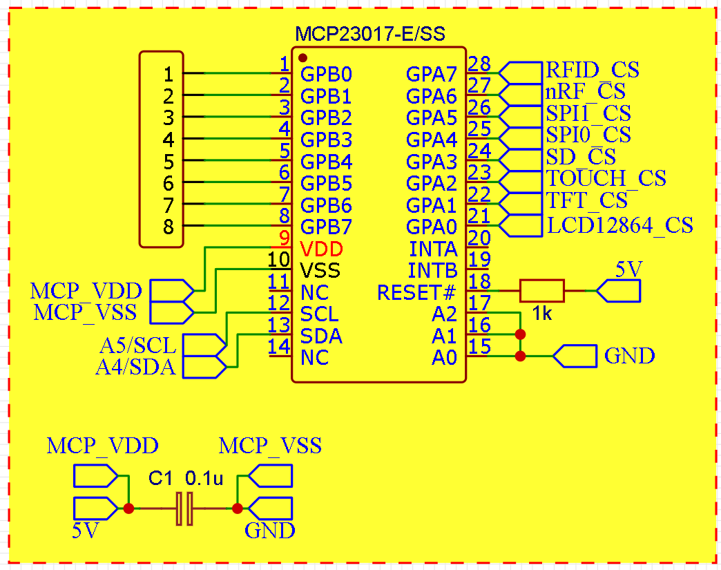

Yes, I'm thinking of using different SPI modules and I designed this circuit.
What you think ? Is it good ? I used 8 pins for on board spi modules and ported the other 8 pins for any other use.

I was thinking that MCP23017 can use SPI but it doesn't. So in case of I2C the read/write would be on SDA apparently.
If you are building a complex SPI-based system, why make it even more complex by using i2c bus also? It should be easier and neater to stick to one bus system. Could you use a humble 74hc595 instead of pcf/MCP chips?
Or, if you have 3 Arduino pins available, a 74hc138 ?
