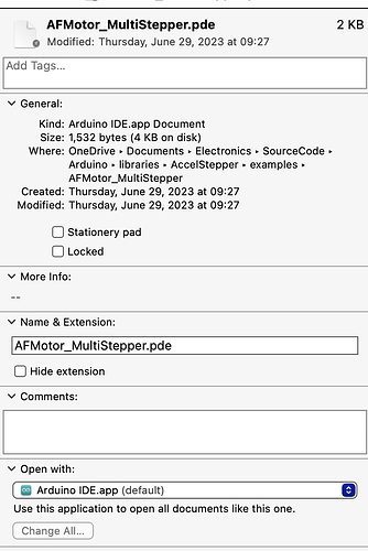

Just change the default program used to open the PDE filetype. If Mac, do a get info for any pde and do the obvious. For windows, it's somewhere in the CP, I just don't recall, maybe try searching? Renaming the files is the wrong way, 5 minutes after you get done there is an update and your renames are history.

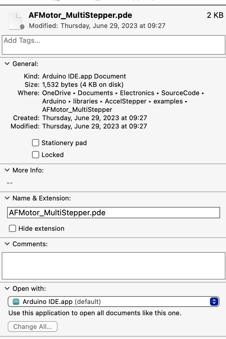

I don't know about *nix, but both Mac and Windows have a mechanism to relate .pde files to the Arduino IDE. Here is the Mac solution. When you change the first one the 'change all' option is offered. I have attached a link for how to do the same in Win 11 and Win 10

I like that idea. I have Windows, easy to do. will try it.
Hmm, my default apps show PDE used for Processing, which I use for a couple projects. I don't want to screw that part up. I don't know if it will but this is not a big issue, so I'll wait for the next Arduino, or subscribe to the nightly builds.
