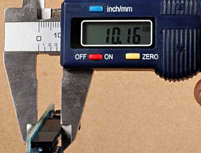

Exactly! I thought I was pretty clear but maybe I left too much to the imagination. Not everyone has a good one though, so here it is with a little more rigor.
The measurement from the bottom of the board to the top of the USB socket is 12.60mm
The measurement from the bottom of the boar to the top of the header is 10.16mm
The difference is 2.44mm. So if there is only 1mm of extra clearance with the typical stackable header, then the problem shown will exist. These measurements were taken from a new, out of the box today, un-abused, genuine Italian Arduino Uno R3.
BTW, also shown below is the measurement of the plastic block of a typical male header. It measures at 2.36mm which would go a long way toward eliminating the problem.

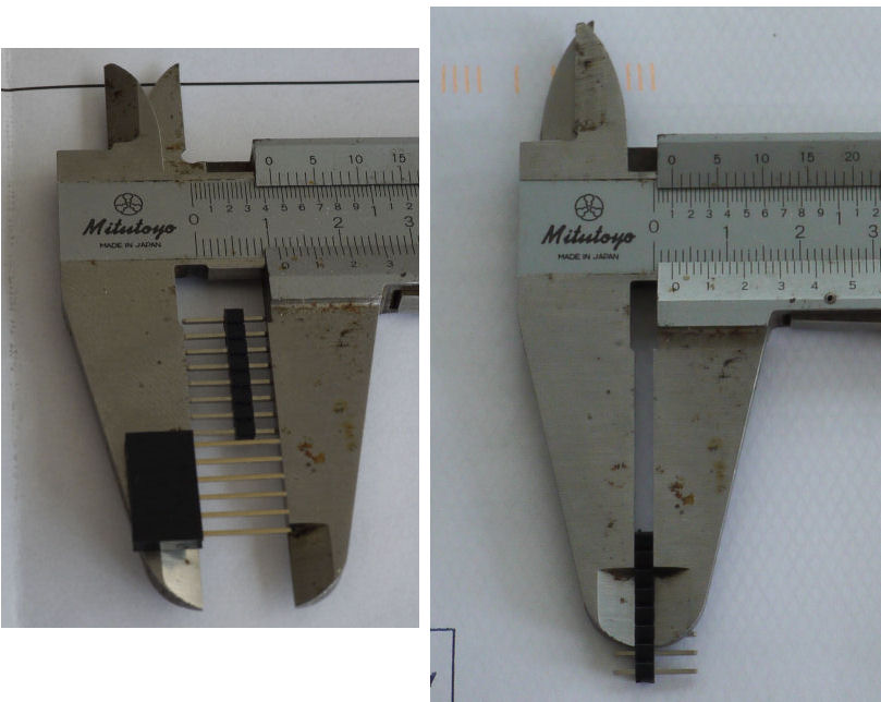

Clearly, if this is to be fixed, it will be fixed by addressing the length of the pins rather than their position. So yes, a male pinrow to hand measures 11.25mm overall while the exposed length of pin on the standard stackable header measures 11.1mm, but I’m far from sure that 0.15mm is anything to write home to your mother about, and this presupposes that laboriously pulling the pins through the plastic block, to ensure that advantage taken from the extra length, is actually worthwhile. Trust me, I've done it, and it isn't.
The only thing that matters in the pictures, both, is the only thing that cannot be seen and of which there is no mention – the length of the pins. What we do see is a pathetic exercise that depends on scrounging plastic pinrow blocks, which might be better employed for their original purpose, and sloppy soldering, which may result in the pins not being properly bedded down.
Imagination has little to do with this but measurement has quite a lot to do with it. Indeed, an absurd preference for using male headers in a situation like that is more likely to be the cause of the problem than a solution. I say that simply because I am unaware of male header with extra long pins and such a predeliction may obscure the view of stackable headers that fill the bill.

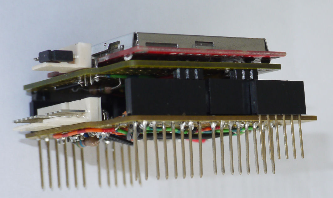

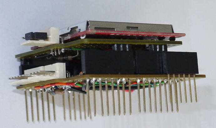

The top picture below shows a storebought ethernet shield clearing the dreaded USB port with daylight to spare and with a homebrewed terminal board on top clearing the RJ45 socket. The pins simply go to the bottom of the socket, like God and Arduino intended
Those needing more rigorous demonstration may see the minimal merit of male pins over a stackable header evident in the second picture.
The third picture shows the comparative length in the only thing that counts – the amount of visible brass.
