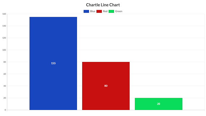

In this video it is also possible to see a problem that I am also facing, which is these sudden drops in some values.
Correct result (Expected)
Wrong result (It is currently happening)
