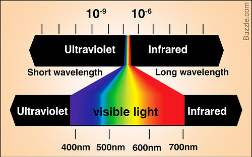

And the photo diode is not normally frequency specific and relies on packaging material filters to limit the frequency response. To detect the colour temperature of the light source you need a different sensor (maybe the TCS3200) or need colour gels over the receiver.
Typically silicon photo diodes and transistors are sensitive across the whole spectrum, any wavelength less
than or equal to the silicon bandgap, right up to UV, but the sensitivity drops as you go from red to blue, but
this means its no use for detecting colour - you need three different sensors for each primary colour, and
they need to be calibrated somehow - the integrated colour sensors do all this for you.
