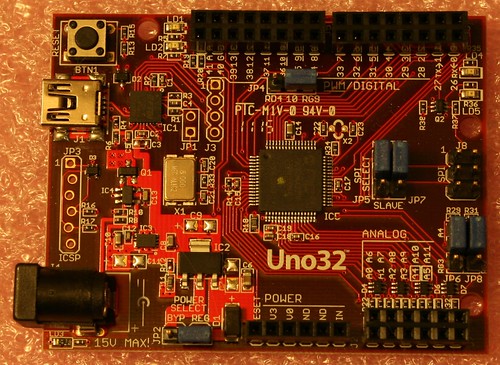

Well, I've done this for Arduino and Arduino Mega, so I might as well continue. Here (linked to) is an "annotated" picture of one of the Uno32 boards, with notes describing most of the significant features (and some of the insignificant features as well.)
