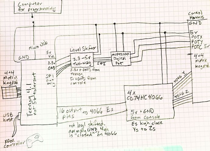

Picking up stray voltage when handling 4+4 matrix keypad. What could be wrong?
I have a project to convert an old game console to a modern USB controller. It uses a Teensy 4.1 with USB host to interface with the xbox game controller and a standard 4+4 matrix keypad using keypad.h.
The game console has a wiring harness with GND, +5v, 4+4 matrix keypad lines, a POTX, POTY and POTC (5v) for a two-axis potentiometer joystick.
The Teensy outputs to a set of 4 CD74HC4066 switches using 16 output pins for a total of 16 switches. The switch inputs (E pins) are connected directly to Teensy output pins. Low is an open switch, high is a closed switch. The 4066 outputs (Y and Z) are matrixed into 8 lines and go to the console harness.
The Teensy also has an SPI connection through a bi-directional 3.3 to 5v level shifter module to an MCP42100 digital pot. This is connected to the console POTX, POTY and POTC lines. The level shifter is connected to the Teensy 3.3v and GND and the console 5v and GND.
This is working with one problem.
The 4+4 matrix keypad attached to the Teensy picks up stray voltage when I touch it. It is not mounted yet and just handling it sometimes causes a line to go high (confirmed with a logic probe). I can see the logic probe's high LED fade in as I move my finger across the pad. This causes the 4066 switch to close and registers and a button press on the console. If I don't touch the Matrix keypad there are no stray keypresses.
It stops happening when I plug the Teensy into the computer using USB. It does not happen when the Teensy is getting all power from USB (disconnected from console) and it doesn't happen when getting power from the console and connected to the computer with USB with the USB power line cut.
It seems like it must be a ground issue but I don't know enough about electronics to know how to fix it.
Does anyone have advice on what can cause this or how I can fix it?

I will take a SWAG it sounds like a grounding problem. Your schematic is not complete and the power and grounds are missing among many other things.

gilshultz:
The power and ground are coming from the console harness and are the two lines in the top right. of my diagram.
Interesting. You seem to be decoding the 8 inputs from the keypad into 16 outputs then using four cd4066 switches to encode back to 8 inputs for the console.
Anyway, have you used decoupling capacitors (say 100nf) on the cd4066 chips ?
Do you need pull down resistors on the 8 key pad inputs (cd4066 outputs) on the console? I guess those switches have a very high impedance when open.

Yes, I'm decoding and reencoding the matrix keypads. I want to have the Teensy sit in the middle so I can use keypresses for different controller modes, etc.
No, I don't have decoupling capacitors on the 4066s. I can try that. I didn't put any pulldown resistors on the 4066 outputs. The original controller is a simple carbon dot switch without any pulldown, and this part seems to be working fine. I'm seeing the high voltage on the Teensy's 4+4 matrix, which translates into a high output pin to the 4066 input.
Decoupling is not optional for logic chips. Often datasheets don't mention decoupling because you
are supposed to know this :slight_smile:

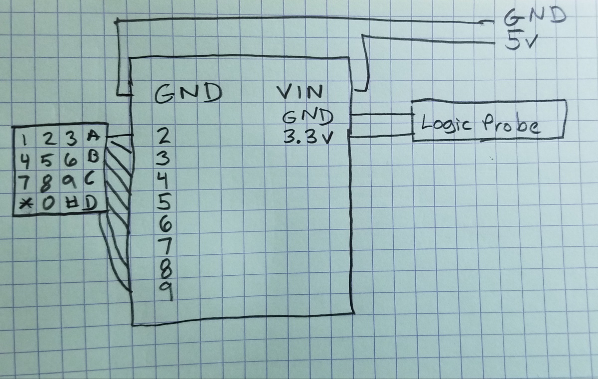

I've simplified my circuit to the bare bones and still have this issue.
The Teensy 4.1 is hooked up to the console 5v and GND. The keypad is attached to pins 2-9, and a logic probe is attached to the 3.3v and GND pins on the Teensy.
Normally the row pins 2-5 are high, column pins 6-9 float per the logic probe. Pressing a key causes the corresponding column pin to go high.
The problem occurs when the Teensy is hooked up to the console's 5v supply. Handling the keypad without pressing a button causes the column pins to sometimes go high. The logic probe's high LED gets brighter as I put more of my hand on the matrix keypad. I am not pushing on it or causing the switches to close.
This only happens when using the console power and ground. If I power it through another 5v supply it does not happen. If I power it with the console and attach a USB cable with ground, it does not happen. I measured the console power with a voltmeter at 4.95 volts.
I've tried both a 1uf and .1uf decoupling capacitor across the power supply lines. I tried a pulldown resistor on the column lines. Neither stopped the pins from going high when I handle the keypad.
How could my hand cause this voltage to cross the membrane switches without pressing them - only when using a certain power supply?
Thanks for any help.

I see here at least 2 issues relating to non-AVR platforms for a keypad.h library:
Do you get any compiler warnings or messages relating to INPUT_PULLUP ? The method, sometimes used, of switching an input pin pullup resistor on, by writing a HIGH to it, is probably AVR specific.
For this project, an arduino IR learning remote control, I wrote my own matrix keyboard handler: Arduino IR Learning Remote Control - Exhibition / Gallery - Arduino Forum . If you really get stuck, I can pick the code out for you to see if that helps.
Edit:
I've just looked at it again. There is something wrong here because pins should never float:
Which keypad library are you using. The one from the "issues" link above or another ?
The implementation of the keypad handler in that IR learning remote control project uses pin change interrupts because pressing a pin may also have to wake the device from sleep mode. It may not be that simple to adapt it for a Teensy 4.1

Thank you for this, it looks very promising :grinning: I'll have to rewire my full breadboard for a full test.
Initially your code was not working on my Teensy 4.1. All digitalReads reported the pins as LOW. I found that the Teensy requires a 10 microsecond delay between setting the pinMode to INPUT_PULLUP and reading a HIGH value from it. LINK
After making this change, the code works perfectly and I don't see the phantom key presses from handling the keypad.
I wonder if the keypad.h library is doing something similar, and the indeterminate nature of reading the pin right after setting it to INPUT_PULLUP was nudged by my hand being on the keypad?
Replacing the keypad.h library with your code fixed the issue. My keypad matrix is working perfectly now. Thank you!
