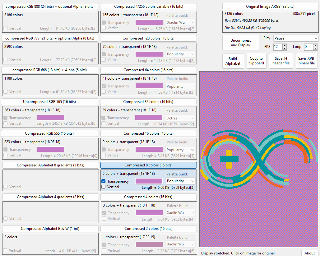

I compared the result with some other RLE implementation in the Arduino world, and it seems I do a bit better. But my process is not fully automatic, because depending on some images, sometime it is better to pick a particular compression scheme. So I wrote a program to pick the best result for a given usage. Here’s for example the Arduino Community logo, which has a transparent background and a size of 500x251, encoded as a PNG in 51491bytes.
https://support.arduino.cc/hc/article_attachments/12416033021852
You can see that this particular image compress well as a 8 color palletized image, in 6759 bytes, preserving the transparency.

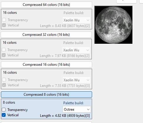

Also, the moon example, 128x128 pixels in 16 colors compress to 8400 bytes, and again I do a bit better with 7731 bytes
I can even do a compression in 8 colors, with a result of 4939 bytes removing a little of the pixels information, but not much.

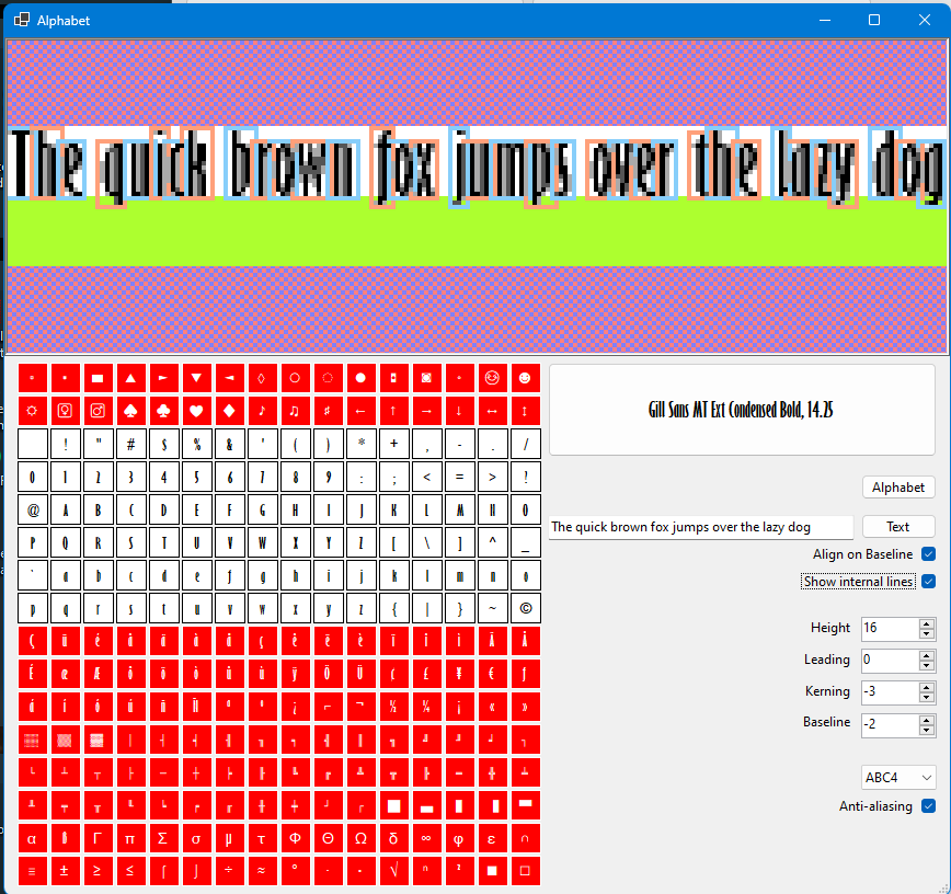

As my implementation can do sprites with some transparency, I thought it would be nice to consider the sprites as letters, thus having a way to write with any kind of font that Windows can display. I used as an encoding scheme CP437 (extended ascii) so many Western European languages can be written + a few additional characters, unlike some other implementations that limit to non-accentued characters. See https://www.lookuptables.com/text/extended-ascii-table
Here’s the result using a fancy font, only 16 pixels high and of course using antialiasing to have the letters looking nice, using only 4 colors (3 + transparency)

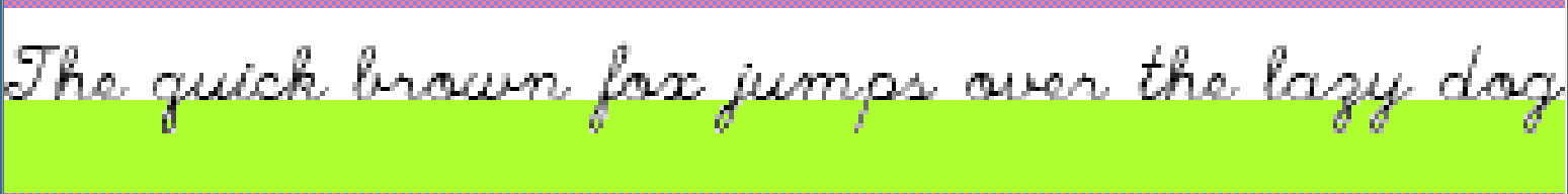

You can use even fancier fonts with complex ligatures, like this one
Screenshot 2025-01-03 080146
Enlarge for details:
And showing the various letters:
As you can see, at the end it is just a juxtaposition of sprites, taking into account the various parameters of a font (leading, kerning, baseline…). Each letter is a highly compressed buffer of bytes. in 2, 4 or 8 colors gradient
