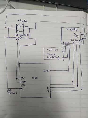

i need help with how to tune the parameters of PID . And can anyone verify if my code is correct. im trying to do the position control of a dc motor with pot acting as a feedback using arduino and PID.
thanks for your help in advance.

I'm using an arduino uno and a dc motor with the potentiometer inbuilt with the motor acting as a feedback .no im not trying to make it a servo .i have made a very rough sketch of my connections .
Thanks for the diag.
Your code shows you have declared a value of 600, but it would be better for you to attach another pot so you can change the position value as the code runs.
Can you post link/data/picture of your motor/pot assembly please?
Tom... :slight_smile:
I hope you do not have the pot connected to the motor input terminals.
This would be better.

The motor is already enclosed in outer casing and sealed due to which i might not be able to show the connections. and the value that is declared as 600 is a setpoint i have given as reference value .i have to use the serial monitor to control the position of the motor .the pot ranges from (60-960). since i was not able to view the serial plotter and serial monitor at the same time that why i gave a reference value.
