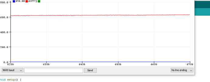

Using the excellent PID library from Brett Beauregard.
Using a LDR to control a LED
when the light levels are high it works fine as shown
the set point is 600 and as the natural day light level falls it goes haywire as shown below
Ive tried messing around with the PID manual tuning settings Kp, Ki, Kd but without success. It seems to me as if the LDR can't read a constant light level as the light falls.
Any help would be much appreciated
thanks

thanks for helping me. I went back to the project the next day and with a Kp=0.1, Ki=10 and Kd=0 I got the following perfect result
with the ambient light high and a setpoint of 600 I got this
the red graph is the ambient light level falling on the LDR. Its just above 600 and the blue line representing the led output is clearly at zero as expected.
Now with the ambient light level below 600 we get
this is clearly what i'm after a constant output. I wasn't getting that yesterday.
