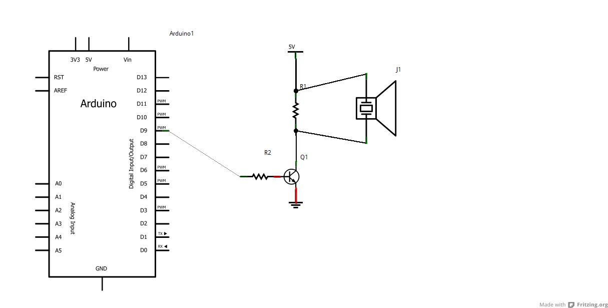

Hello I have been looking for information and cant seem to find it anywhere so please help. My circuit has 5vDC. 12vDC is available.
I am trying to drive a piezo transducer buzzer with my Arduino as part of a project. At the moment Im using a radio shack internally driven 273-060 and a boost converter circuit (at 12vDC and a peak of 20vDC) to adjust the volume. I would like to use something like a 273-073 and drive it externally but i cannot find all the information needed.

I did some breadboard testing with the radio shack buzzers. Here are the results and new questions.
The external drive seems louder at 5vdc then the internal at 12vdc. Which is good because they are cheaper and i can eliminate the boost converter circuit. Saving time, money, pcb space, and current draw from my 7805. It also sounds clearer than the internal drive.

Here is the circuit i am using for others that have trouble finding it.
R1 im using 470ohms. Formula i used (Vcc * 100 ohms) 470ohms is good enough for my testing
R2 1k
Q1 2N4401
I am thinking about using a 12vdc supply for the piezo but i would have to add a 7812 + caps just for the piezo. As my input is 15vDC.
