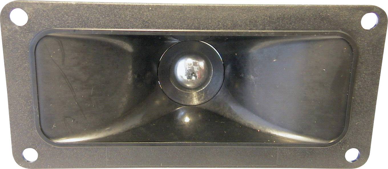

I want to drive this 12V piezo buzzer:
I have attached the circuit I am using.

When run I can hear the tones changing but the sound level is really really low. I have measured the voltage between buzzer pins and it is 12V (as expected) so the MOSFET seems to be properly working.
This piezo buzzer should be louder (I have tested it with this 12V tone generator http://www.kemo-electronic.de/en/Car/Modules/M048N-Ultrasonic-Generator.php )
I am making any mistake?

I have managed to make it a bit louder by placing a 1K resistor in parallel with the load (piezo buzzer).
What I am wondering now is why this resistor makes it louder and how to calculate the proper resistor value in order to have the loudest output.

I fact scrub the whole idea because the resistor will not make any difference apart from reproducing the original condition when it it too high. The resistor makes a difference because it is giving the FET something to switch. The piezo alone it too high an impedance to allow the FET to actually switch.
