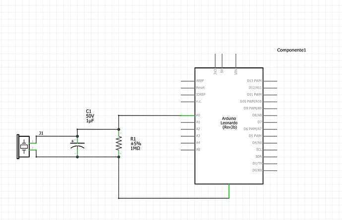

I'm attaching a picture of the piezo I'm using. I don't have any electronic specification for it.

I'm using 1M Ohm resistor in parallel with the piezo, and later, added a 50v 1uF cap, also in parallel, and appearently it smoothes the signal, and it is somehow easier to detect the peak, at the cost of a longer time to reach zero again.

So how, exactly, are you getting your readings?
Again, please post your schematic!
Please also post your code, and some good, clear photos of your setup.
Apologies, didn't get home sooner to get the code and schematics, here they are:

Do you have the sensor flat on a surface when you test, or do you have its edges suspended with a ring so the piezo can flex in the middle.
When you think about it, that is how its transmitting of sound occurs, by vibration of the centre section of the element.

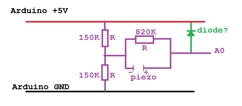

Those piezo elements can generate voltages much higher than 5V and even worse generate Negative voltages, neither of which is good for an Arduino
You are probably damaging your Arduino analog input.
This is also an usefull topic
https://forum.arduino.cc/t/how-to-wire-a-piezo-as-an-impact-sensor/901726
I have made my own version based on that topic but I must say that I have had an defect in my analog input reading after one night/day with unpowered Seeeduino board and connected piezo wiring. I had done a long test of running board and connected piezo continuesly for some days without problems. I had to think about a comment from @Wawa that the input is max Vcc + 0.5V... maybe I add a diode from analog input to Vcc to catch this?
I keep the lowest and the highest reading and use the substraction as 'sensorresponse'.
