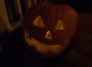

Just in time for Halloween, I posted a video of an Arduino jack-o-lantern project I call "Pimp Your Pumpkin." It's a basic project and makes use of a proximity sensor to make your halloween pumpkin a little more interactive.

Maybe put the sensor in the eye...?

Jeremy, that's a good idea, or perhaps carve a dedicated hole for the sensor itself. Some people may want to put the sensor somewhere else entirely.

I made a slight variation for mine. The jack-o-lantern stays dark until someone activates the motion sensor, then it lights up. I used the random LED flickering code for the 4 high-brightness LEDs to make it look like a candle. I also used a 70ft motion sensor that is usually used for security lights.
Awesome! It must be a pretty cool effect in the dark, approaching the pumpkin to see it magically "light up!" Are you able to post video of it?
Didn't make a video, I wouldn't want to frighten everyone.
