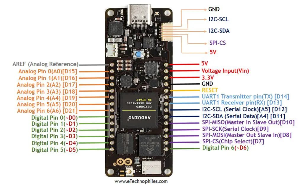

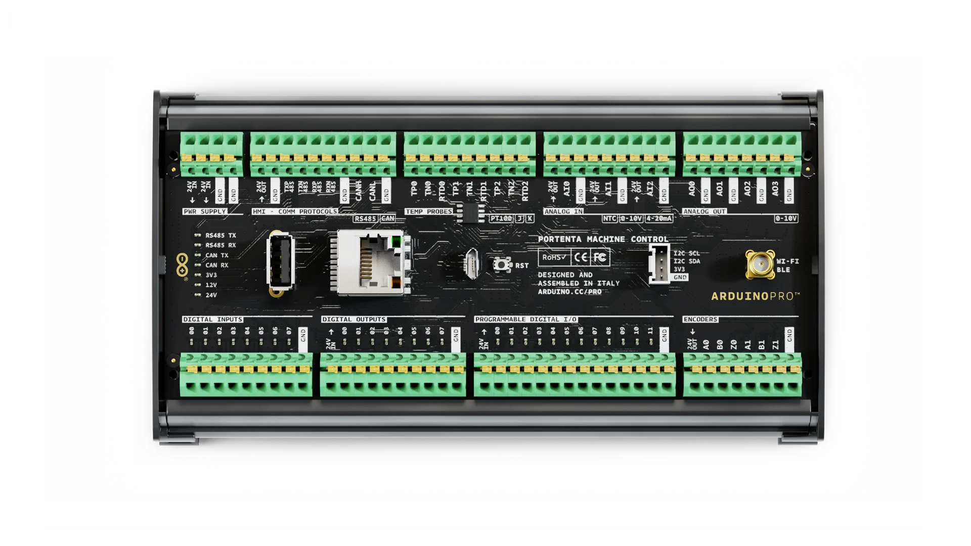

I am using the Portenta Machine control board for my project, and I am trying to control a stepper motor. However I am struggling to find the corresponding Pin names. In the portenta H7 board, D6 pin is a PWM pin. But how do I use this for the Portenta machine control where my motor is connected to Digital output 6?
Could anyone provide me the name of each pin?

I found this at: https://www.etechnophiles.com/arduino-portenta-h7-intro-pinout-specs-parts/#board-layout-of-arduino-portenta-h-7
This is the board that i am using. The Portenta H7 is in-built.
