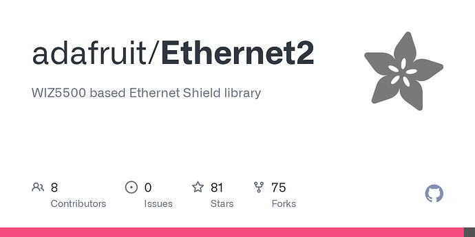

A noter : la librairie Ethernet2 est obsolète :
This library is no longer going to be used, since the official Arduino library has been updated and works great GitHub - arduino-libraries/Ethernet: Ethernet Library for Arduino
