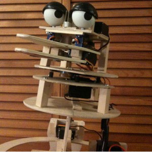

The animatronic @larryd posted is mine. It uses a Mega, MP3 shield and a standalone servo controller with 11 servos. The sketch is actually a run-time module for a proprietary animatronic control language I designed, which is stored on a microSD card.
