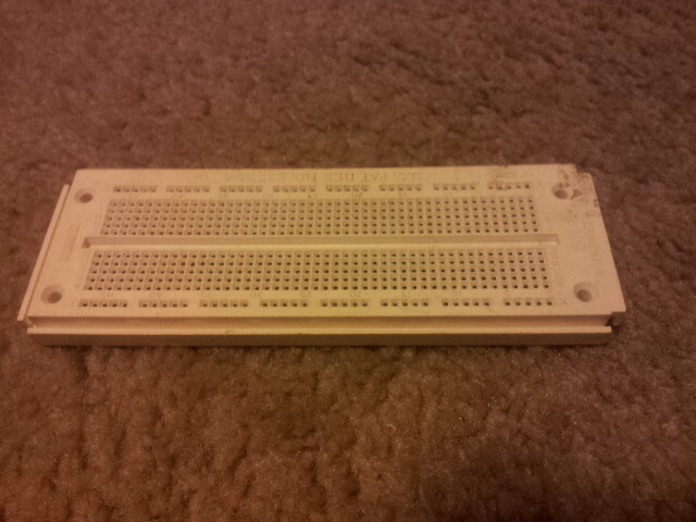

Guys, I have some really old (From the late 1970s....) RadioShack breadboards that won't work with headers.
They were not designed for wires this large. The square openings in the plastic are simply not large enough to allow the header pins to be pushed in.
The breadboards made these days have much larger holes in the plastic.
I've attached a photo of both types for people to see.

bperrybap:
--- bill
Well then the answer is clear, isn't it? Buy some modern larger breadboards.
OldSteve:
Well, not quite.
While the newer breadboards do have larger openings in the plastic to accommodate larger wires and header pins, the quality of the internal "socket" metal inside the breadboards varies considerably between boards.
So some boards don't work very will with small/thin wires and many of them will have issues after using header pins because the internal socket metal doesn't spring back tightly any more after being stretched for the header pins.
Just something to keep in mind: Using headers in a bread board is hard on the internal socket and after using a header, the holes used may not work very well if at all with small gauge wires like 1/8 watt resistors.
--- bill

Sorry, reading your last post, I thought you were the OP, hence my answer.
If the holes are too small for a given pin size, to only option is to use a breadboard with bigger holes. That seems to be just common sense to me.
I'm not sure if the OP wants to hear this but if the holes in the plastic ARE large enough BUT the metal clips inside seem to be blocking the hole because they are not lined up, it IS possible to rework a breadboard by removing the back and inspecting , removing and reworking the clips that are inside. They are spring metal and they can be bent back to the correct position if they don't line up. This process begins with a visual inspection with a magnifying glass and a single header pin used to test the hole/clip. The process ends with a continuity check of each of the holes in each row. Tedious , yes , but done correctly only takes an hour or so.

I've had to realign the metal clips before. However, I did it by using a very pointed pick and didn't have to remove the back. I stuck it in the hole and wiggled it until it went in the clips and then moved it around a bit to realign them.

Good idea if it's badly misaligned.
So far, I've been lucky and got away with either jiggling them into place with a single pin, or always inserting pins on a slight angle, with the couple of bad ones I've had.
Don't tell anyone I told you this but sometimes I steal clips from an old breadboard to replace bad ones in another breadboard. I've also used Radioshack electronic cleaner to resurect a 30 year old large breadboard with the banana jack terminals.
