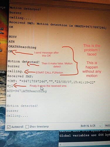

Pir security system with remote on off using relay
This project i use ardunio nano
And I use relay module power on and off which goes to Pir sensors.
All the code and function work well until receive service sms or any kind of sms to sim 800L.
After relay on it detect motion because of pir sensor suddenly on that is normal . But after that function work well and detect motion .
If i send message not related to command and if it received any kind of sms service message it detect as motion detect and make call , THAT IS THE PROBLEM
What is the problem I cant understand :pleading_face::pleading_face:
Help me experts please......

You have to apply message parsing. There are some examples in the internet. By using message parsing, you will be able to extract the content of the message. And you will need to write some condition in your code too. For example, if the message reads 'ON', the relay should be On.
Does your sms really start with "Received SMS: " ? In the line before that you add that same text to the print statement.
Maybe it should be
if (sms.startsWith("AT+CMGDA=\"DEL ALL\" OK"))
or
if (sms.startsWith("AT+CMGDA=\"DEL ALL\""))
By the way, why did you try to place an image in the middle of the code :wink: ![IMG_3728|375x500](upload://6gByeNstbMfPOyvsbL0IfkMX6cR.jpeg)
Image ? That was a mistake :nerd_face:,
Ok i ll try it but i cant understand can you explain deeply
You say those something interrupt with whe. sms receive
I tried servel code without using any mechanical thing to on and off the system by sending commnd . But it didnt work as I wish, so i add relay between pir power line now the relay on and off by sending command , when relay is off pir 5v supply not connect to it so the sensor are not work.
That is why i use relay to on off ,

This is my project friend
I use ardunio nano
Sim 800L
2 pir sensors
And realy
Diagram is correct there is no issue with the circuit ,
Relay is connect between power source and pir sensors . Relay can switch power which goes to pir sensors.
Ok
Relay on off by sending sms command.
Relay is off position
Now i send sms not the command it dosent do anything elas of false trigger as motion detect.
Then i send command to relay ON
Now
Relay is on position
Now is the problem happen.
When sim received any call or sms from carrier service like service sms, credit balance sms
First it detect as motion then make buzzer high and make call and after that it show the sms is received in serial monitor .
It again happen when i send OFF command and it make call end of the all function it show command message and then switch off relay.
I connect DMM to PIR sensor if any error happen with them but they are not triggered. If unwanted sms received to sim 800L it start to show as motion detect on serial monitor and make call.
That is the problem i faced can you understand it
This happens after turning on the relay, when the sim receives a service message or something else, it says motion detect, then the call function is turned on, but then the message is displayed. I want to stop this from happening. All other functions in the code work fine
Then, when I sent the command to turn off the relay, the motion was detected again and when the call function was finished, the relay was turned off after reading the message it received.
:smiling_face_with_tear:Wrote it with google translator​:relieved:

මේ කෝඩ් එක අප්ලෝඩ් කරාට පසුව එය හොදින් වැඩ කරන්වා. එහි අන්තර්ගත රිලේ ඔන් සහ ඕෆ් විදාන , මෝශන් එකක් ඩිටෙක්ට් වුනාම කෝල් ෆන්ක්ශන් එක හරියට වැඩ කරන්වා.
නමුත් වෙනත් ආකාරයක එස්එම්එස් එකක් හෝ කෝල් එකක් සිම් 800 මොඩියුලයට ලැබුන විට එය මෝශන් එකක් ඩිටෙක්ට් වුනා සේ සලකා කෝල් ෆන්ක්ශන් එක ක්‍රියාත්මක වීම සිදුවෙනවා.
තවද රිලේ මොඩියුලය ඕෆ් කරන්න කමාන්ඩ් මැසේජ් එක යැවීම සිදුකල පසු එය මුලින්ම මෝශන් එකක් ඩිටෙක්ට් වුනා සේ ස්ලකා කෝල් සහ බසර් ෆන්ක්ශන් එක ඔන් වෙනවා ඉන් පසු තමා ලැබුන කම්න්ඩ් එක එක්සිකියුට් කරන්නෙ.
නමුත් මම බලාපොරොත්තු වෙන්නෙ මට අවශ වෙලාවට සිස්ටම් එක ඔන් කිරීම සහ මෝශන් එකක් ඩිටෙක්ට් වුනොත් කෝල් ෆන්ක්ශන් එක ඔන් වෙලා ක්‍රියාත්මක වීම.
නමුත් සිදුවන්නේ මෝශන් එකකින් තොරව ලැබෙන මැසේජ් මෝශන් එකක් ලෙස සලකා ක්‍රියාත්මක වීම.
After uploading this code it works fine. It contains relay on and off sensors, when a motion is detected, the call function works properly.
But when the SIM 800 module receives a different type of SMS or a call, the call function is activated considering that it has detected a motion.
And after sending the command message to turn off the relay module, it first detects a motion, the Slaka call and buzzer function is turned on, after that it executes the received command.
But I want the system to turn on when I need it and if a motion is detected the call function will turn on and run.
But what happens is that the message received without a motion is treated as a motion

ප්‍රශ්නය තමා
කමාන්ඩ් මැසේජ් එකක් යවලා රිලේ එක ඔන් වුනාට පස්සේ සිම් එකට වෙන මොකක් හරි මැසේජ් එකක් ආවම මෝශන් ඩිටෙක්ට් කියලා සීරියල් මොනිටර් එකේ ප්‍රින්ට් වෙලා කොල් ගන්නවා නම්බර්ස් වලට ,

Thank you very much i ll check it :handshake::smiling_face_with_three_hearts:
Setup-Start
Code running comes from file
C:\Users\Haritha Ranathunga\Desktop\aluth_code_eka_august_7_haduwe\aluth_code_eka_august_7_haduwe.ino
  compiled Aug  7 2023 19:09:41
SIM800L software serial initialized
send to sim800 #AT#
trying to connect to Sim800...
Connected to Sim800!
send to sim800 #AT+CMGF=1#
send to sim800 #AT+CNMI=1,2,0,0,0#
send to sim800 #AT+CMGL="REC UNREAD"#
Received SMS: #AT
OK
AT+CMGF=1
OK
AT+CNMI=1,2,0,0,0
OK
OK
Received SMS: #
+CMT: "+94717897246","","23/08/07,19:10:21+22"
ON12
send to sim800 #Relay is ON#
Received SMS: #Relay is ON
Motion detected!
buzzer
calling....
send to sim800 #ATD+94717897246;#
send to sim800 #ATH#
send to sim800 #ATD+94762;#
send to sim800 #ATD+94781;#
Received SMS: #ATD+94717897246;
OK
ATH
OK
ATD+94762;
OK
NO CARRIER
ATH
Searching
OK
Motion detected!
buzzer
calling....
Received SMS: #
+CMT: "+94717897246","","23/08/07,19:12:36+22"
**Test sms after relay on**
AATH
Searching
OK
19:16:16.695 -> Motion detected!
19:16:16.695 -> buzzer
19:16:36.689 -> calling....
19:16:37.735 -> send to sim800 #ATD+94717897246;#
You see when i send sms it trigger as motion detect
That is the problem ifaced with code.

best regards Stefan
First motion detect normally happen because power on relay and current pass to pir sensors.
And 2 motion detect because I send sms to test
3rd one i move infront of pir sensor
19:43:25.186 -> Setup-Start
19:43:25.186 -> Code running comes from file
19:43:25.186 -> C:\Users\Haritha Ranathunga\Desktop\aluth_code_eka_august_7_haduwe\aluth_code_eka_august_7_haduwe.ino
19:43:25.285 ->   compiled Aug  7 2023 19:37:25
19:43:25.336 -> SIM800L software serial initialized
19:43:25.385 -> send to sim800 #AT#
19:43:26.352 -> trying to connect to Sim800...
19:43:26.402 -> Connected to Sim800!
19:43:26.402 -> send to sim800 #AT+CMGF=1#
19:43:27.384 -> send to sim800 #AT+CNMI=1,2,0,0,0#
19:43:28.401 -> send to sim800 #AT+CMGL="REC UNREAD"#
19:43:29.435 -> Received SMS: #AT
19:43:29.435 -> OK
19:43:29.435 -> AT+CMGF=1
19:43:29.468 -> OK
19:43:29.468 -> AT+CNMI=1,2,0,0,0
19:43:29.468 -> OK
19:43:29.518 -> AT+CMGL="REC UNREAD"
19:43:29.518 -> OK
19:43:29.518 -> #
19:44:27.052 -> Received SMS: #
19:44:27.052 -> +CMT: "+94717897246","","23/08/07,19:44:35+22"
19:44:27.148 -> ON12
19:44:27.148 -> #
19:44:27.148 -> "if (sms_SS.indexOf('ON1') != -1)" sms_SS.indexOf("ON1")=50
19:44:27.182 -> send to sim800 #Relay is ON#
19:44:28.190 -> Received SMS: #Relay is ON
19:44:28.190 -> "before motion detect" relayStatus() changed from 0 to 1
19:44:28.232 -> "before motion detect" digitalRead(pir_sensor1) changed from 0 to 1
19:44:28.315 -> "before motion detect" digitalRead(pir_sensor2) changed from 0 to 0
19:44:28.398 -> "Top of loop" relayStatus() changed from 0 to 1
19:44:28.432 -> "before motion detect" digitalRead(pir_sensor1) changed from 1 to 0
19:44:41.393 -> Motion detected!
19:44:41.393 -> buzzer
19:44:41.393 -> delay(20000)
19:45:01.376 -> delay(20000) done
19:45:01.376 -> calling....
19:45:01.411 -> delay(1000)
19:45:02.379 -> send to sim800 #ATD+94717897246;#
19:45:02.429 -> delay(25000)
19:45:27.380 -> delay(25000) done
19:45:27.380 -> send to sim800 #ATH#
19:45:27.429 -> delay(5000)
19:45:32.429 -> delay(5000) done
19:45:32.429 -> send to sim800 #ATD+94762;#
19:45:32.480 -> delay(26000)
19:45:58.426 -> delay(26000) done
19:45:58.426 -> send to sim800 #ATH#
19:45:58.460 -> delay(6000)
19:46:04.426 -> delay(6000) done
19:46:04.426 -> send to sim800 #ATD+94781;#
19:46:04.496 -> delay(27000)
19:46:31.464 -> delay(27000) done
19:46:31.464 -> send to sim800 #ATH#
19:46:32.478 -> Received SMS: #ATD+94717897246;
19:46:32.526 -> OK
19:46:32.526 -> ATH
19:46:32.526 -> OK
19:46:32.526 -> ATD+94762;
19:46:32.526 -> OK
19:46:32.559 ->
19:46:32.559 -> NO CARRIER
ATH
Searching
19:46:32.559 -> OK
19:46:32.592 -> #
19:47:07.155 -> "before motion detect" digitalRead(pir_sensor2) changed from 0 to 1
19:47:07.191 -> Motion detected!
19:47:07.191 -> buzzer
19:47:07.191 -> delay(20000)
19:47:27.182 -> delay(20000) done
19:47:27.182 -> calling....
19:47:27.223 -> delay(1000)
19:47:28.181 -> send to sim800 #ATD+94717897246;#
19:47:28.222 -> delay(25000)
19:47:53.209 -> delay(25000) done
19:47:53.209 -> send to sim800 #ATH#
19:47:53.256 -> delay(5000)
19:47:58.238 -> delay(5000) done
19:47:58.238 -> send to sim800 #ATD+94762;#
19:47:58.271 -> delay(26000)
19:48:24.238 -> delay(26000) done
19:48:24.238 -> send to sim800 #ATH#
19:48:24.287 -> delay(6000)
19:48:30.241 -> delay(6000) done
19:48:30.241 -> send to sim800 #ATD+94781;#
19:48:30.287 -> delay(27000)
19:48:57.233 -> delay(27000) done
19:48:57.233 -> send to sim800 #ATH#
19:48:58.302 -> Received SMS: #
19:48:58.302 -> +CMT: "+94717897246","","23/08/07,19:47:15+22"
19:48:58.369 -> test messge aATH
Searching
19:48:58.369 -> OK
19:48:58.403 -> #
19:48:58.403 -> "before motion detect" digitalRead(pir_sensor2) changed from 1 to 0
19:49:51.249 -> Motion detected!
19:49:51.249 -> buzzer
19:49:51.249 -> delay(20000)
19:50:11.237 -> delay(20000) done
19:50:11.237 -> calling....
19:50:11.273 -> delay(1000)
19:50:12.263 -> send to sim800 #ATD+94717897246;#
19:50:12.298 -> delay(25000)
19:50:37.257 -> delay(25000) done
19:50:37.257 -> send to sim800 #ATH#
19:50:37.333 -> delay(5000)
19:50:42.279 -> delay(5000) done
19:50:42.279 -> send to sim800 #ATD+94762;#
19:50:42.331 -> delay(26000)
19:51:08.302 -> delay(26000) done
19:51:08.302 -> send to sim800 #ATH#
19:51:08.346 -> delay(6000)
19:51:14.293 -> delay(6000) done
19:51:14.293 -> send to sim800 #ATD+94781;#
19:51:14.364 -> delay(27000)
19:51:41.312 -> delay(27000) done
19:51:41.312 -> send to sim800 #ATH#
19:51:42.393 -> Received SMS: #ATD+94717897246;
19:51:42.393 -> OK
19:51:42.393 ->
19:51:42.393 -> BUSY
19:51:42.393 -> ATH
19:51:42.393 -> OK
19:51:42.393 -> ATD+94762;
19:51:42.428 -> OK
19:51:42.428 ->
19:51:42.428 -> NO ATH
Searching
19:51:42.428 -> OK
19:51:42.462 -> #
