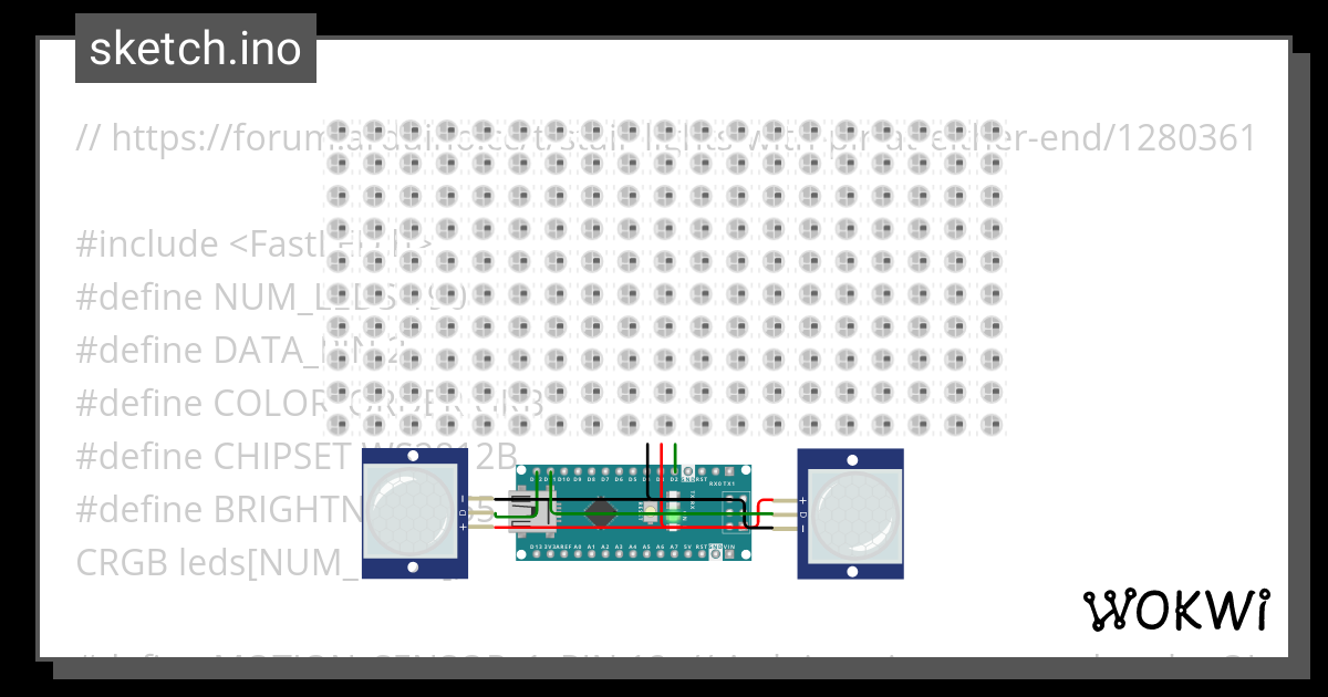

Sorry I forgot to mention the board. It’s a nano and I’ll be using just 2 WS2812B pixels. I am looking to have those 2 pixels light up only during the duration of the track being played on the dfplayer.
OK. Come back when you’ve tried my two suggestions .
Thank you for making that change for the start up, nice and quite now.
I might have not been clear in my original post, but the code I had posted is working just fine. I was look to adjust the code to include the function to add leds, and for them to light up once the PIR is triggered and stay lit up for roughly the length of the track (around 8-10 seconds) then turn off. Again, I apologize for my lack of knowledge on this and appreciate the help.
Since you and emily seem to be good with copy/paste, here is a pre-made sketch with your neopixel need...
How far have you got?
Did you study the many tutorials, such as this example;
