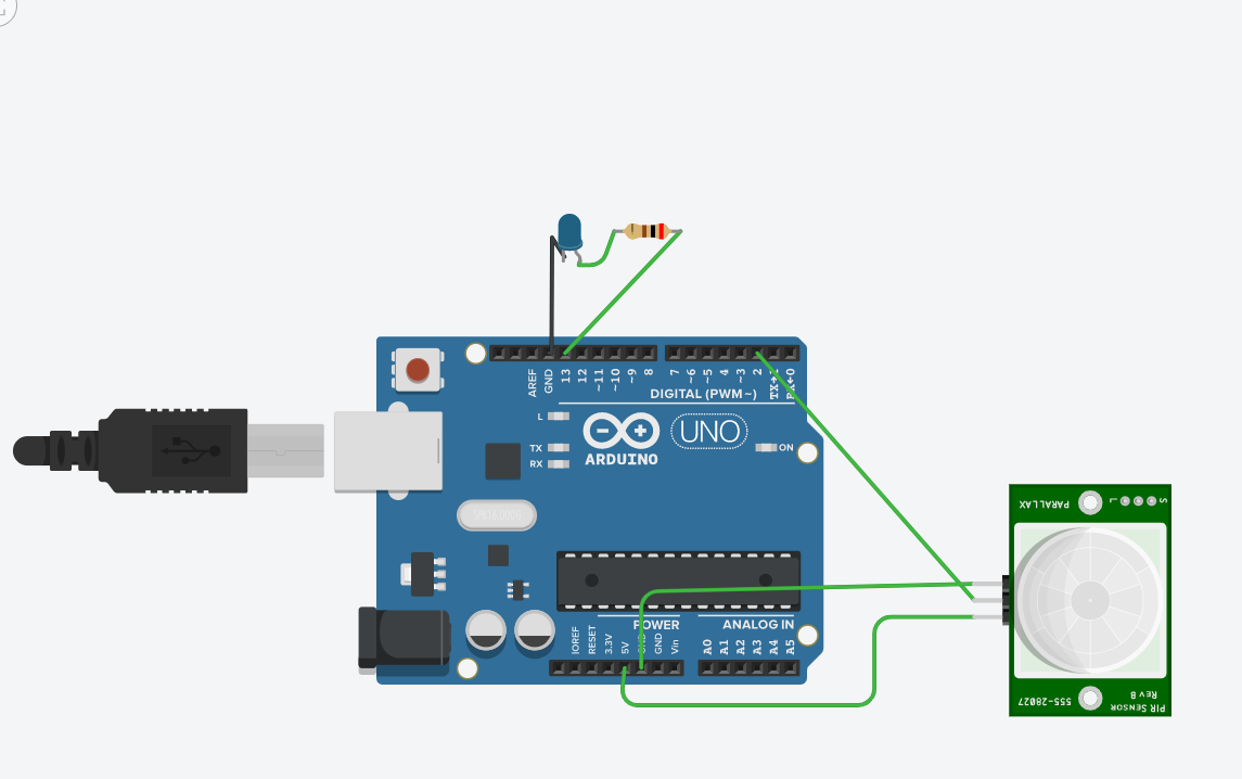

PIR Sensor is always HIGH
hi guys .The problem is that the sensor always detects motion and the led lights up. what could be the problem?

i tried another program but it didn't work either:
const int PIRinput = 2; //PIR connected here
const int led = 13; //Led connected here
int motion = 0;
pinMode(led,HIGH); //led as output
pinMode(PIRinput,LOW); //PIR as input
//reading the PIR status and stores to variable motion
motion = digitalRead(PIRinput);
if (motion == HIGH) {
digitalWrite(led, HIGH);
else {
digitalWrite(led, LOW);
You should read this: PIR Motion Sensor | LEARN.PARALLAX.COM it is from parallax and shows the sensor, how to hook it up and code for it. You are missing a resistor I believe, they show one on the output, however I do not know why. Remember these things take there time and respond very slowly.
The two trim pots are usually set in the middle when you buy a PIR sensor.
You must first turn the 'time' pot fully anticlockwise.
If you don't, then the internal timer of the PIR keeps it's output HIGH for about 3 minutes.
And that is repeated the moment the PIR senses a new movement.
If you leave the pot fully anticlockwise, then this time is reduced to about 3 seconds.
Then you can use the Arduino to program the timing you want.
Leave the 'sensitivity' pot in the middle.
Leo..
