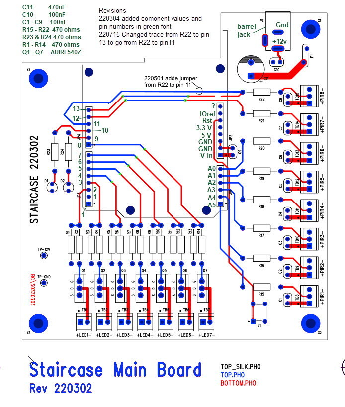

Hello Arduino Forum,
Created sketch to turn on a two LEDs (LED6 and LED7) based on
a trigger from two motion dectectors (PIR [passive
infrared]), input 12 and input 11.
The operation of LED7 by input 11 is as designed,
that is the LED comes on when the PIR is triggered,
stays on for a about twenty seconds and the goes off.
But the behavior of LED6 is baffling.
When the Arduino is powered up both LEDs come on because
when intialized the PIRs send a signal. But then,
although LED7 is operating as expected,
LED6 will come on without being triggered or
come on and stay on without ever going off.

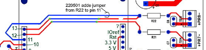

As a test input 12 PIR was removed. But LED6
continues to come on, usually about five seconds
after LED7 is triggered.
So input 12 was tied to LED7 and input 11 sent
to LED6. The same behavior was onbserved with,
in the swapped setup, LED7 exhibiting unpredictable
results and LED 6 operating normally.
Perhaps, with the input 12 removed the value of
val12 is floating and the program mistakes the
lack of a value for HIGH.
Any ideas on troubleshooting?
Thanks.

Hello apf1979,
Sorry, I meant to post the code and forgot.
Code posted herewith below.

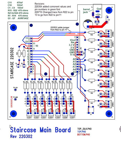

The schematic changed so much in the PCB design that we never
got to updating it. But a JPG of the PCB design is posted. The project
Is actually eight PIRS controlling 7 LEDs with PIRs 1 thru 7 controlling
7 LEDs if the staircase is approached from below and PIRs 8 thru 2 controlling the 7 LEDs is approaching from above.
When the unusual behavior appeared the sketch
was pared down to focus on the the two channels that are erratic.
Thanks.

You have resistors in series from the output of the PIR sensor, is this called out by the manufacturer? It probably doesn't hurt regardless though.
Try a 1 mega Ohm from the board IO pin to ground in case you are getting a floating value and let us know. If it does work, probably best to do them all the same way just in case.
I'm guessing it's an artifact from the code being truncated.
