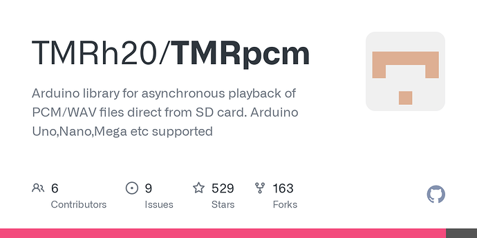

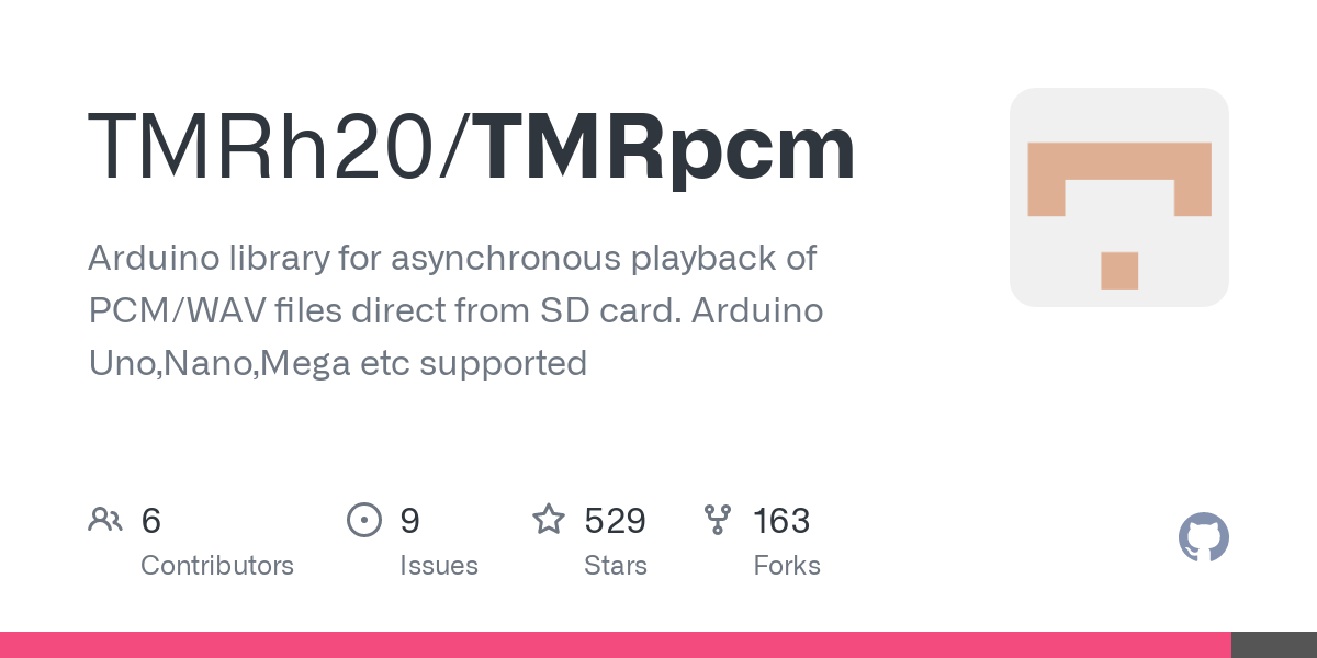

Can we proceed with DF Player on the basis of it's properties of containing 100 folders with each having capacity of handling some 1000 around files ??
The DFRobot player is excellent.
(tmrpcm is a pale comparison, akin to a "parlor trick".)
What's the attraction of folders?
Anyway, DFRobot's library works great - if it is used with a genuine DFRobot player.
