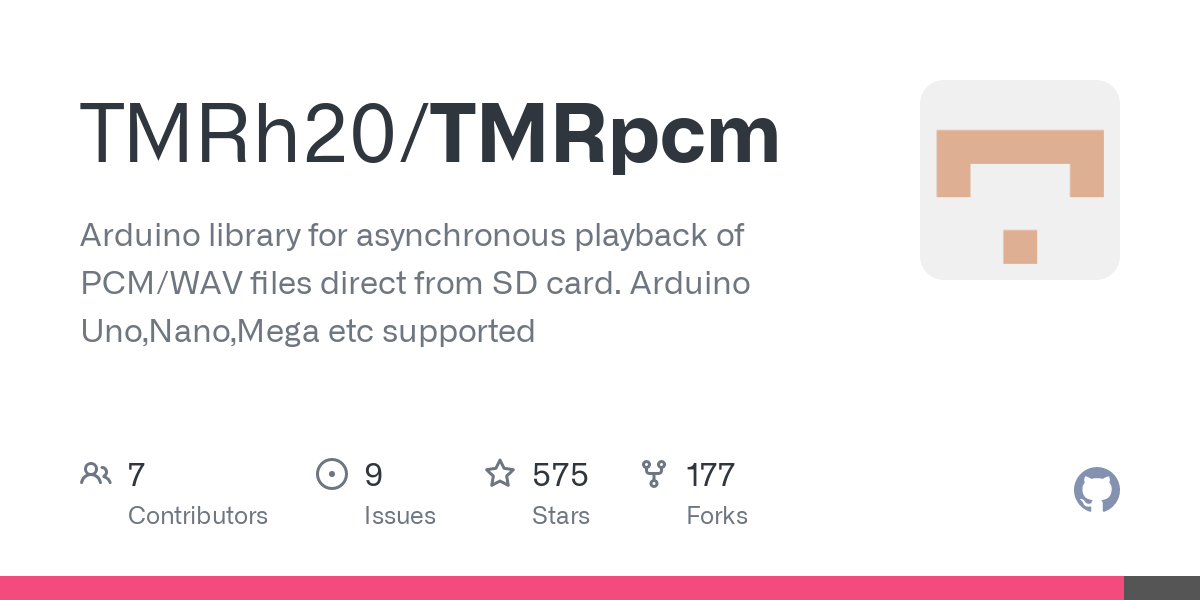

Playing multiple WAV files is actually quite easy... the real problem is the lack of memory in the low end Arduinos is too limiting for storing WAV files in their entirety for easy access. The SD card allows a WAV file to be streamed and played but unless the bitrate is low it's usually limited to a single WAV file streaming at a time.
If however you wanted to mix together, for arguments sake 4 PCM values that can be calculated easily and fast for sample(x) = fn(t) then it's just a matter of adding the individual samples and dividing by the number of samples.
The sample below is very simple. If you have stereo output you can do all sorts of stuff in real-time with the panning as well.
int mixed = (sample1 + sample2 + sample3 + sample4) / 4; // each sample is 0 - 255
sendDAC(mixed);
Personally I would recommend an Arduino Due or a Teensy 3 if considering anything with sound manipulation.
reading more than one file from an SD card and playback through PWM
